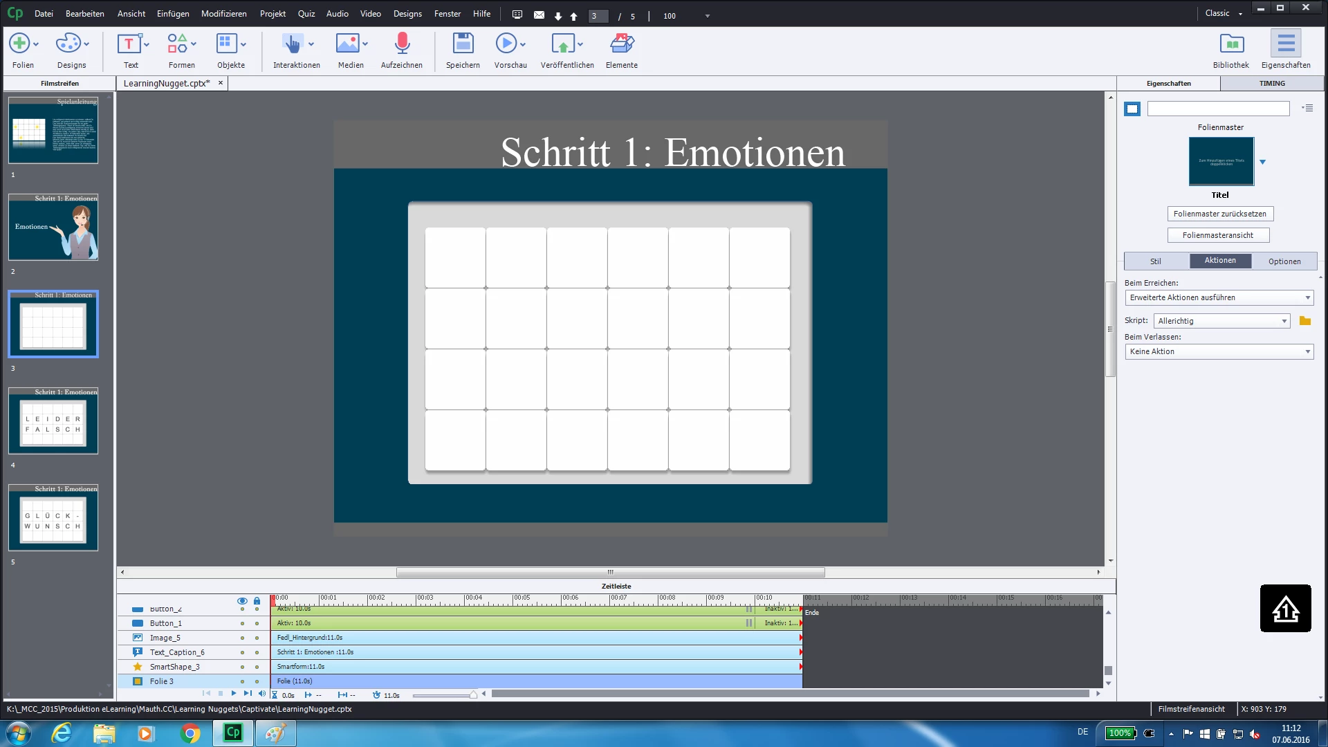

I have to design an alternative memory game. So I made the slide 3 with a pattern of about 24 buttons.
A short peek-view shows the 3 right buttons. Goal of the game is to klick all 3 buttons in about 10 seconds.
If this happens the user should get to slide 5. If he klicks 1 wrong button he will get to slide 4.
I made 3 variables Button01 and gave them the literal "FALSE" - I hope this makes them boolean-like.
By klicking the right Buttons i made advanced actions, which allocats their values to the literal TRUE.
For the whole slide i made the advanced option:
IF (Button01 == TRUE && Button02 == TRUE && Button03 == TRUE)
     go to layer 5 slide 5
The problem is, that this advanced action just starts if the user reaches slide 3 and after this it won't start again.
Is there a possibility to make this advanced action recursive or can I trigger it within the advanced actions of the buttons?

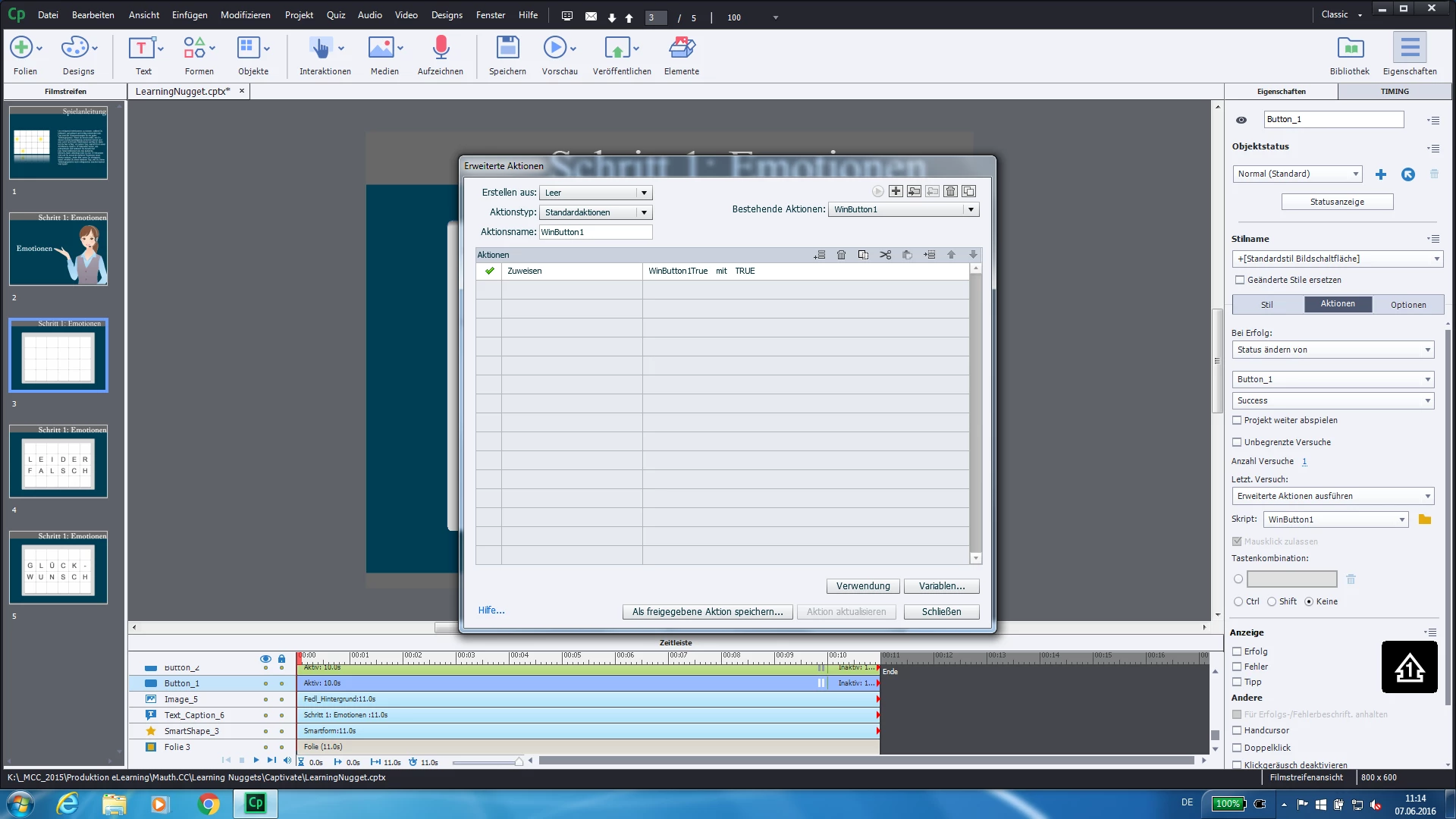

    The current Buttons-AA:
    Like You said. Duplicated for the other buttons and changed the assignments, but in the preview I just see all 3 activated Buttons till the time is up and navigating to the new slide 5 (success is slide 6 now).
    Do not compare SL with Captivate, please, they do not have advanced actions, which are converted to JS or AS on runtime depending on the output.
    Not at all, everything should work perfectly, there must be another cause.
    It has no sense at all to make that slide that long. Keep to the default 3secs, with a pausing point at 1.5secs.
    Check in the Advanced Interaction panel (F9) if the correct advanced action is triggered by the correct button.

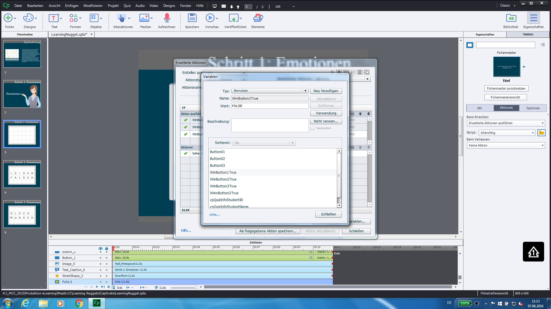

    To debug: add a text container on that slide (shape of caption), time if for the rest of the slide (Continue) and insert the three variables: (mine were labeled v_one, v_two, v_three) using the X-button in the Character part of the Properties panel. When previewing: you should see the variables change. Do you realize that variables are case sensitive, that is one of the reasons I would NEVER use 'TRUE/FALSE'. Are you sure you have exactly the same value for the variables as you are checking in the second decision? Use numbers, so much easier, less risk for typos.
    You should be careful with labeling as well. You cannot use the same name for an action and a button, nor for a variable and an action/button. I don't see it in your screenshots, but it is a tip. That is the reason why I start any object (not actions/decisions) with at least one character defining the type: v_ for variables, SB for shape buttons (I didn't use normal buttons, but shape buttons in the example).

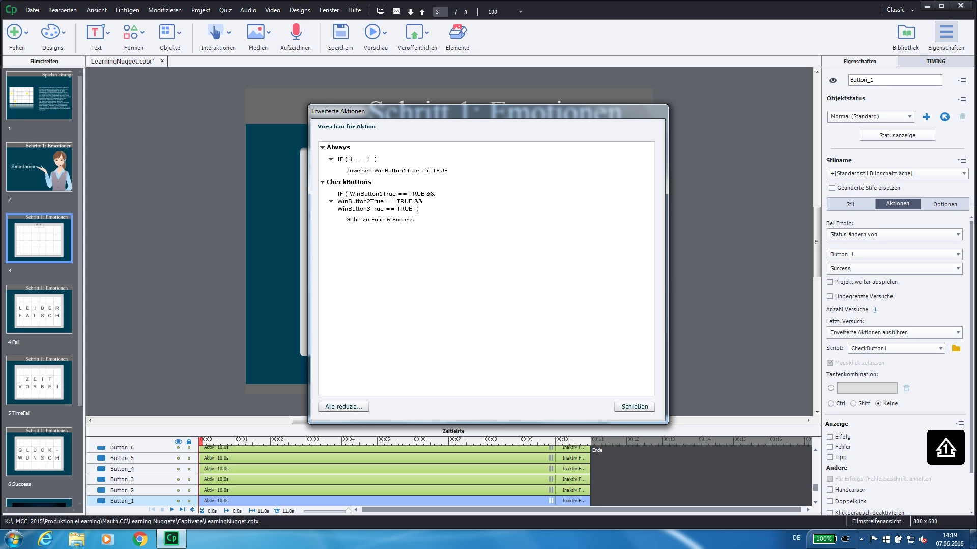

    If you want help, you have to offer more details: which events are you using exactly for each action and screenshots of the complete actions. For conditional actions, use the Preview button (looks like a play button, first top right of the AA window) to see the total action with all decisions.

    The Preview of the action on the slide:
    The variables:
    The button:

    I don't see the complete picture, I think you misunderstand the meaning of a pausing point of interactive objects as well. You cannot force that 10 seconds with the timeline at all!  Your buttons have all one-line advanced actions which means that the playhead will never be released but remains at 10 seconds. The user will get as many time as he wants. That is my first remark. You should need the Timer or Hourglass interaction to force that time limit.
    Secondly: be careful because you attach the end point of the buttons to the end point of the slide (red triangle). More often than not, this is not what you want at all. You cant to extend the button timelines till the end of the slide, use CTRL-E but first get rid of the red triangles.
    I suspect the 'wrong' buttons have the navigation to slide 4. Did you set up 24 buttons? Or do you use the Last attempt actions for the correct buttons?

    Default Captivate behaviour does not allow one Advanced Action to trigger another Advanced Action.
    However, if your output is HTML5, the CpExtra widget does make it possible to trigger an action from within another action.
    If you are publishing to SWF, you may need to use one action to jump to another slide where the On Slide Enter event can trigger your desired Advanced Action and then jump back to your original slide again.  It's a workaround, not a perfect solution.
