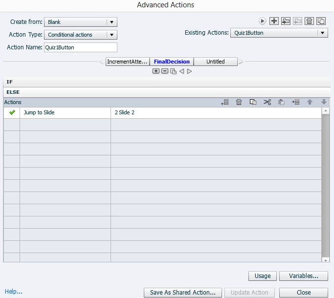

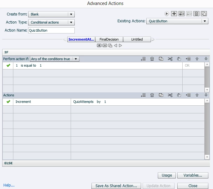

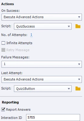

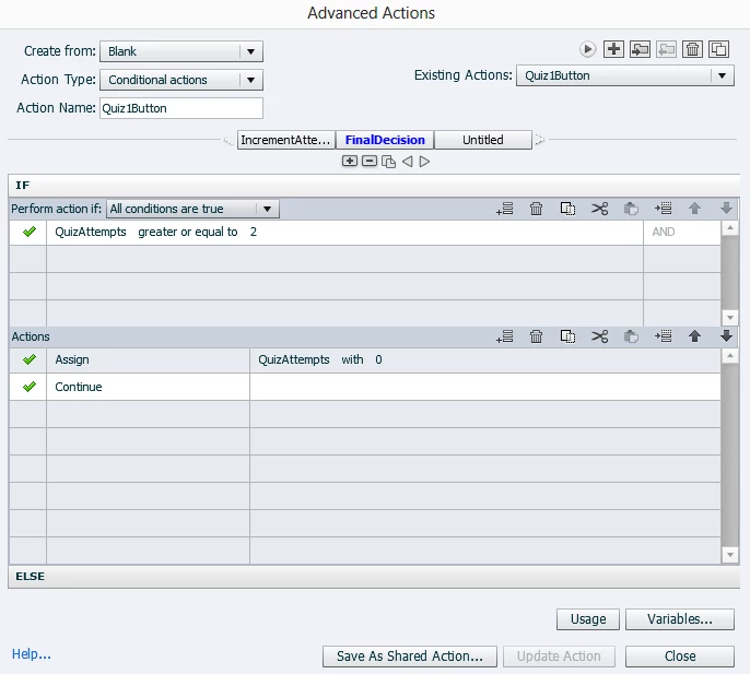

    The remediation workflow is broken by the advanced action that increments the user variable attached to the Submit button on the question slide. Once the variable increments to 2 (second attempt), it resets and the user is taken to the next question slide instead of back to the content slide. We only want to give 1 original attempt (for this remediation flow works well) and then 1 more attempt to answer after the user has reviewed the video lecture. On question slides, the attempts are limited to 1. Another advanced action also resets the variable if the answer is correct.

    Here's a screenshot of the question slide setup:
    Here are the action breakdown screenshots:
    1.
    2.
    3.
