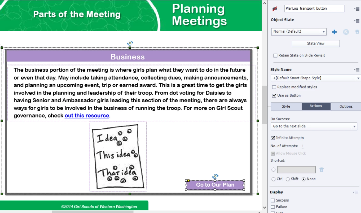

These are the properties below. So far, this is the only project giving us this issue upon publish.

Style is overridden (look at the + sign). What about the object states? Was this created in 8 or 9?
If this is the only project, did you already try to delete that shape button and recreate it (but please use a proper object style, could save you tons of time instead of having to style each button individually). Crossing my fingers that you are not having a corruption popping up.
