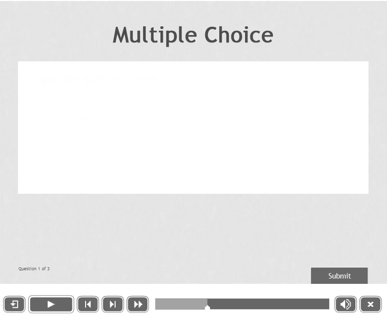

Lieve, I beg to differ.  Try it yourself.
Create a new project, set the Theme to White and add a few quiz slides.
Now select any of those quiz slides, and in Properties tab set Master Slide Objects On Top.
When you publish, this is what you will see:
Could YOU please explain how this would NOT be an issue?
