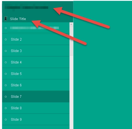

What must I do in order to get the Title that is in the TOC to become the color I want?
Also, how do I change the title size?
I would like to get rid of the Slide Title bookmark icon as well.
Thanks for your help.

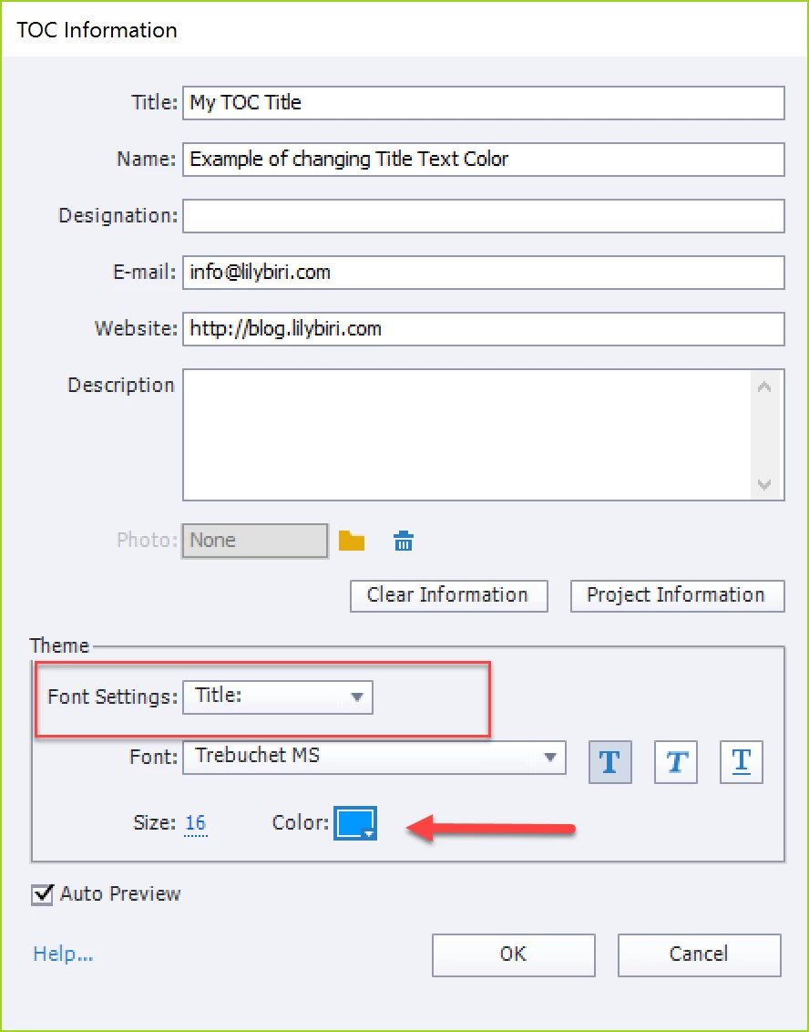

Correct answer Lilybiri
Hi KB in FL, think you posted the wrong screenshot. In the Settings dialog box you can set the background of the Title, but not change the style of the Title text. To do that you have to open the Info... button, not the Settings button:

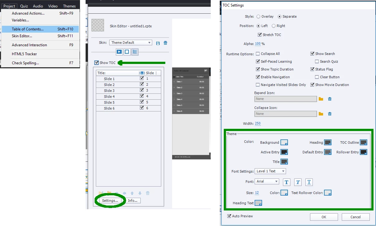

Hello AnotherMe
One of the coolest things about Captivate is that almost every aspect of the presentation can be customized. As far as the TOC goes:
1. In the Project Drop Down, Click Table of Contents
2. The Skin Editor will open. Make sure the Show TOC check box is checked
3. Click the Settings button.
4. Use the Theme Section to customize fonts, colors, and other attributes to your specifications.
Lilybiri
LilybiriCorrect answer
August 1, 2017
