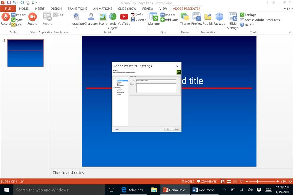

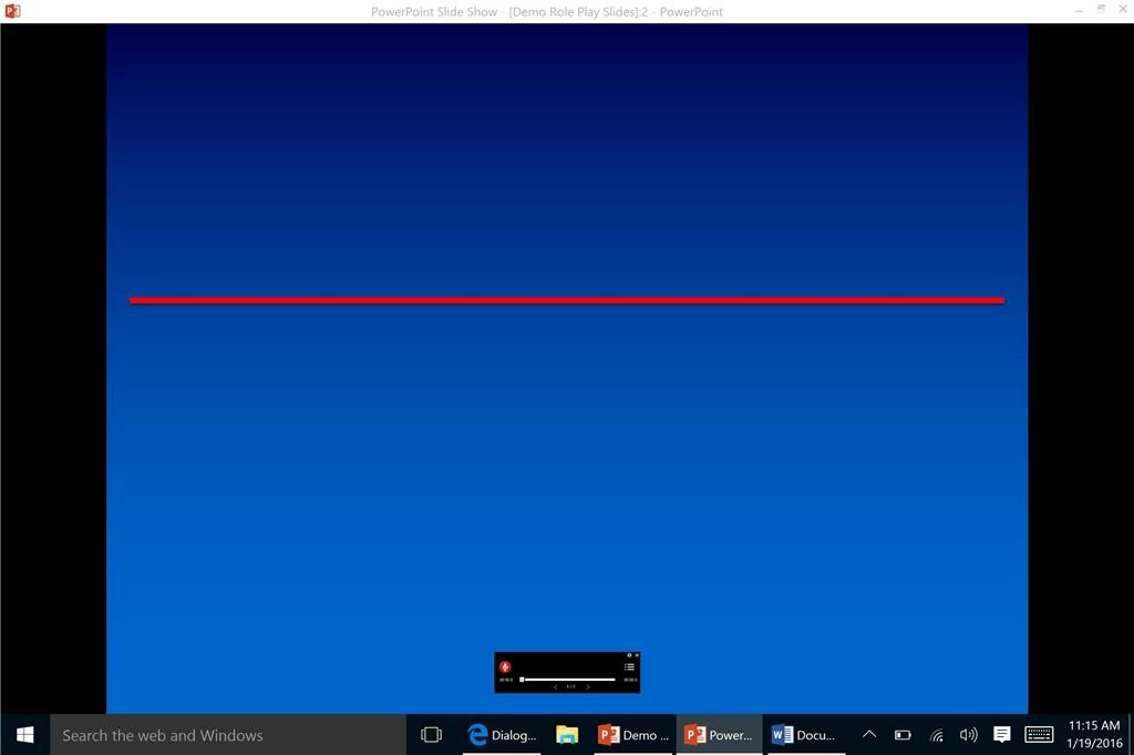

I have a Microsoft Surface Pro 4, with a Windows 10 operating system.  I'm working in PowerPoint 2013 - the dialog boxes that pop-up are SO small that the text is barely readable.  The size of the PowerPoint slide I'm viewing is fine -- it's only the dialog boxes that are minuscule.  Is there some setting I can change to make the dialog box size (and text) larger?  I don't need to make everything larger -- just the dialog boxes and the text inside them.

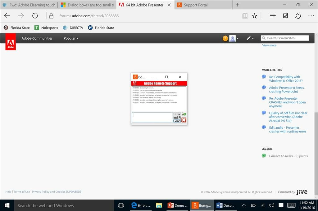

This also happened when using Microsoft Edge while I was in contact with Adobe support.  See all attached screen shots.  So -- it seems like an issue with Adobe products, not just with Presenter & Powerpoint.  Any suggestions would be greatly appreciated!
