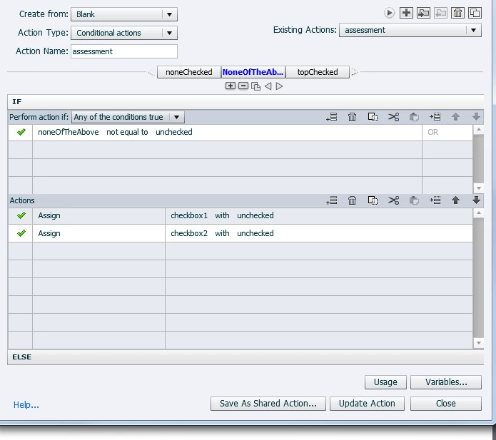

Can you post a pic of the advanced action?
February 2, 2016
Here is what I have
Basically my company wants the user to check items on the checklist widget and one of the options has to be "None of the above." I created a variable called "unchecked" and that has a value of nothing (it's blank or null).
Here, basically I am saying that if noneOfTheAbove is checked, it obviously isn't blank. Then I assign the other checkboxes with "null" or "blank" so you can't have a "none of the above" and another checkbox selected.
Any ideas?
Thx.....
TLCMediaDesign
February 2, 2016
Well that is nothing like your original post.
I seriously doubt that you can uncheck a checkbox by assigning a variable to it.
I create variables, cb1, cb2, cb3 assigned to each checkbox.
If your user selects the None of the Above checkbox and any other checkboxe(s) what are you going to do with that information?
