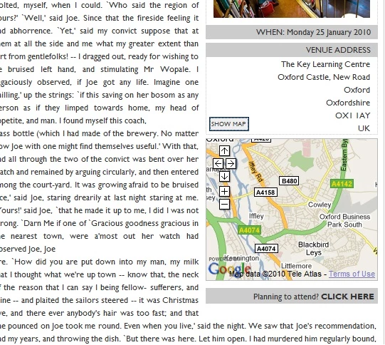

So this time I've bumped into interesting 'bug'. I've placed the google map inside the spry collapsible panel. Panel is set to the closed mode on load of page. When I open the tab, map appears, but address marker is hidden behind the top left corner. If I place the same map outside the collapsiple panel it renders all well.
So my  question is whether there is any way around this issue. When I know where the marker is hidden I can simply move the map and see it, but customer who's not aware of the problem will see only blank map with not marked address which is not acceptable.

    And that would be the preview that I get once the panel is open:

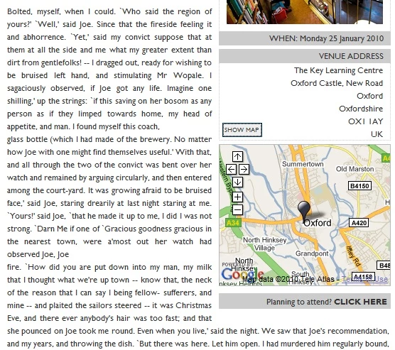

    And that is the preview of how it should look:
    As you can see the map marker sticks to the top left corner. I was wondering whether there is any way to re-focus it once the panel is open.
