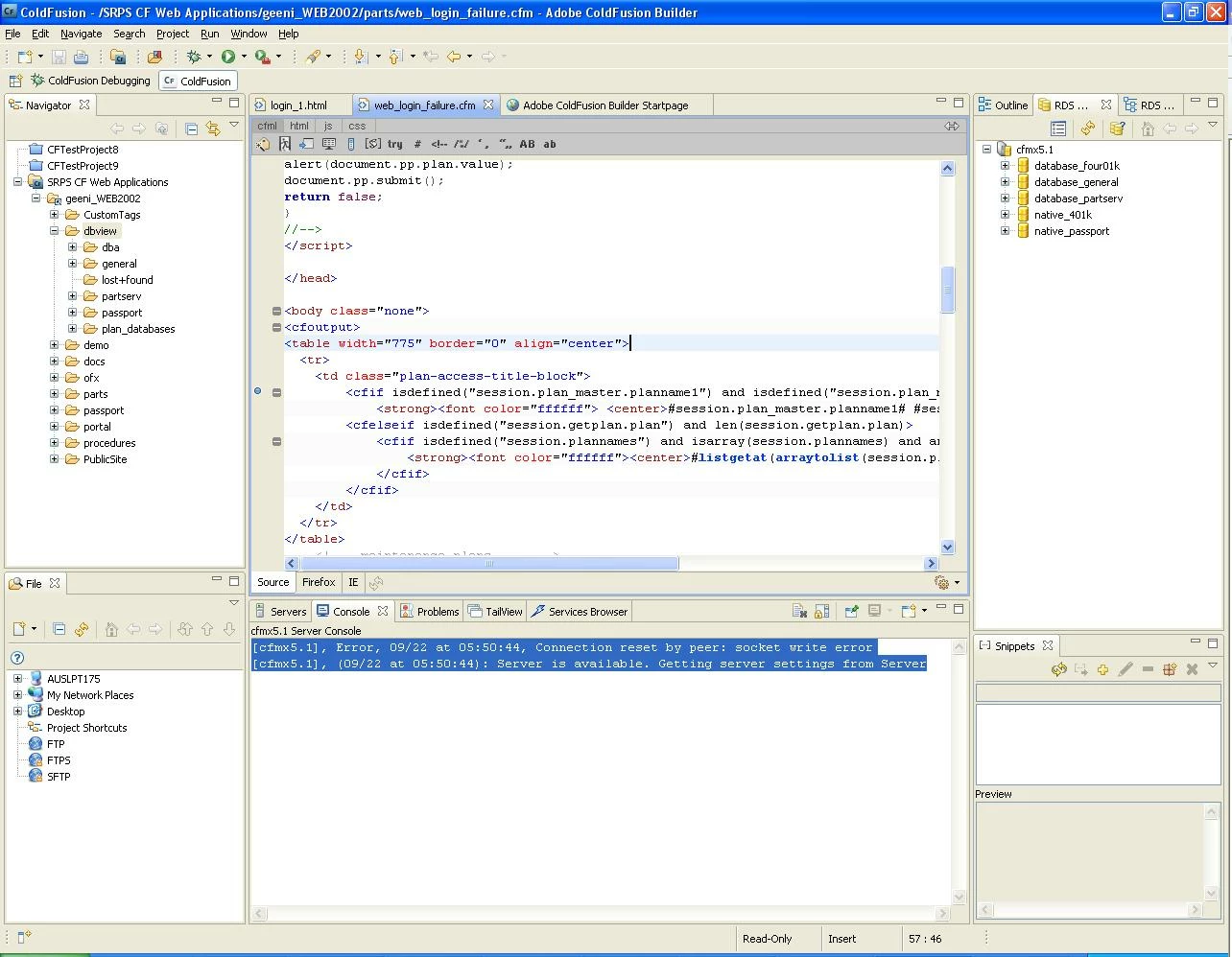

The net effect of this is that I get this when CFBuilder attempts to hook up to the server:
[cfmx.blah.com], Error, 09/22 at 05:50:44, Connection reset by peer: socket write error
[cfmx.blah.com], (09/22 at 05:50:44): Server is available. Getting server settings from Server

I suspect that this line in the above Console log holds the reason: [cfmx.blah.com], Error, 09/22 at 05:50:44, Connection reset by peer: socket write error

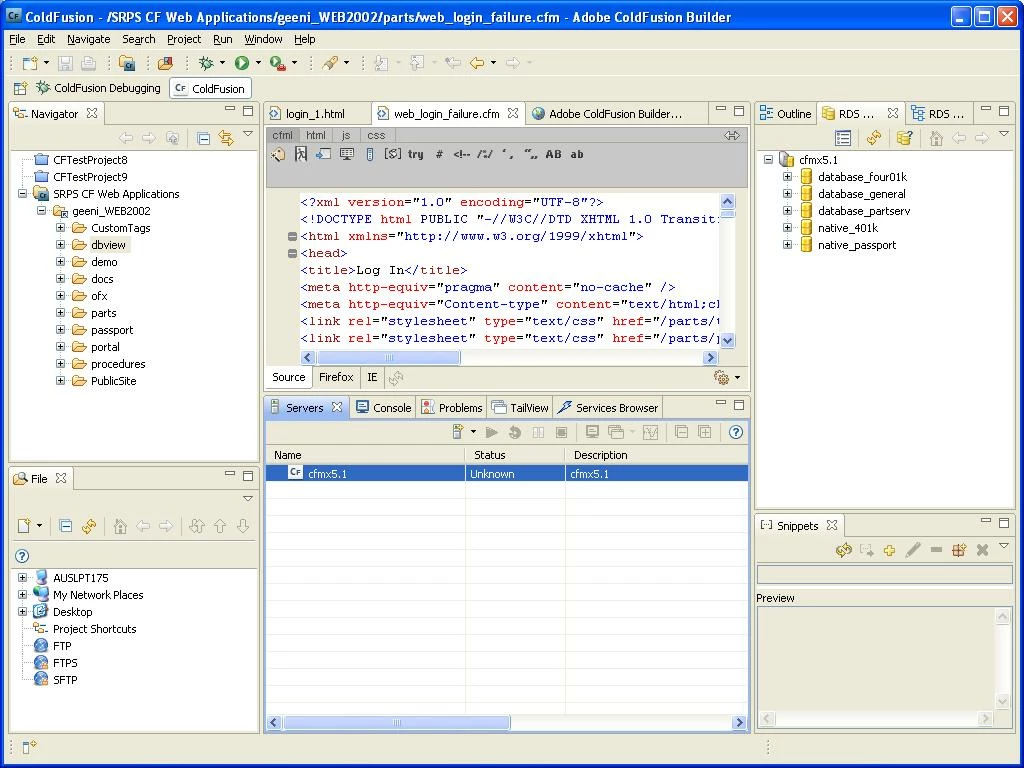

Key piece of additional info on this:
Under the Servers tab I see my cfmx server's status is "Unknown" (see attached screenshot).  As I understand it, this should say "Running".  Can anyone confirm and perhaps offer suggestions?
Joel
