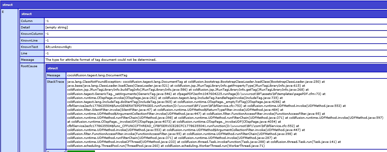

In my application, I am getting an error saying "The type for attribute format of tag document could not be determined". This is happening during PDF generation using cfdocument tag. Note that we are working with PDF files in Memory (ie , we are using the coldfusion option to write a PDF file to a variable by using the name attribute). Attaching the stack trace here.

    Abdul, the error says that you have not set a valid value for the "format" attribute of the cfdocument tag. You say you want a pdf, so you need to add format="pdf", as indicated in the cf docs for the tag.
    Or do you think you are doing that already?

    Thanks Charlie for your response. Yes we do this via attributeCollection as below,

    The above variable we set to attributes scope since we generate PDF in CF thread. Also please note that when we try regenerating pdf 2 or 3 times this issuse never happens.

    OK, interesting. So first, wrap the cfdocument in a try/catch, and when it fails, dump out the attributes scope. You may well find that somehow it's NOT got the values that you think it does--in that moment. And in seeing what IS (or is NOT ) in the dump, you may better be able to tell where the problem is happening.
