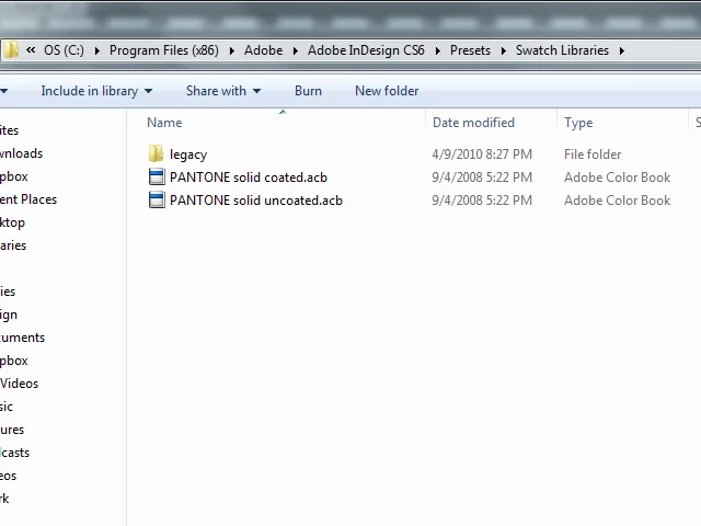

Workaround 1: Replace Pantone Plus with older Pantone color books
Adobe InDesign CS6:
+ Quit the application
+ From the folder Adobe InDesign CS6/Presets/Swatch Libraries/, remove all the libraries that have names starting with Pantone+
+ From any older version of Adobe InDesign (CS2 - CS5) copy all the Pantone libraries with extension .acb and place into: Adobe InDesign CS6/Presets/Swatch Libraries/
+ Similarly, copy all Pantone libraries with extension .acbl and place into: Adobe InDesign CS6/Presets/Swatch Libraries/Legacy/
+ Restart your application

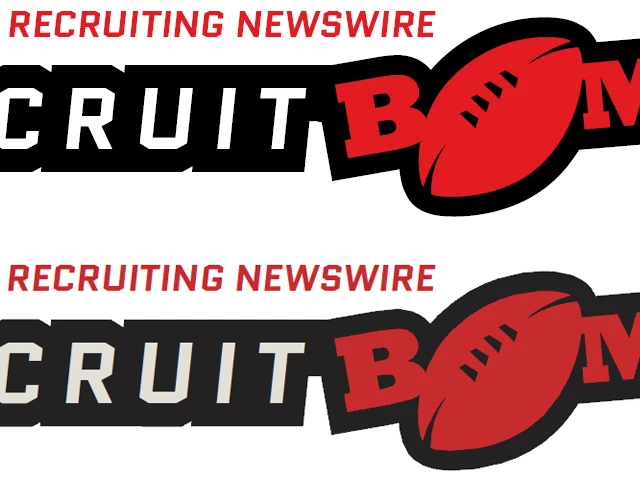

1. The colors, while displaying in InDesign the way I want them to, are now inexplicably exporting improperly (see Fig.1: InDesign layout on top, PDF export below -- even the letters set to Paper [white] are incorrect).
Fig.1

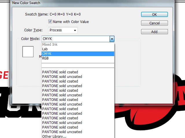

2. Also, the swatch libraries are now duplicating every time I launch InDesign (Fig.2), even though there are only two main swatch libraries (Fig.3), plus the legacy folder.
Fig.2
Fig.3
I don't know how to resolve either of these problems, which are road blocks to all of my current projects.

I've figured out the solution to problem No. 1:
Launch InDesign CS4 (if you still have it, like I do) and Save the Color Settings (Edit menu). Load those settings in InDesign CS6 and your ability to export should be corrected and operate as it used to. (This is what worked for me.)
However, I still have no idea how to stop the color swatch libraries from duplicating every time I create a New Color Swatch. I am up to eight copies appearing in the list now, even though there are still only two libraries in the CS6 folder.
