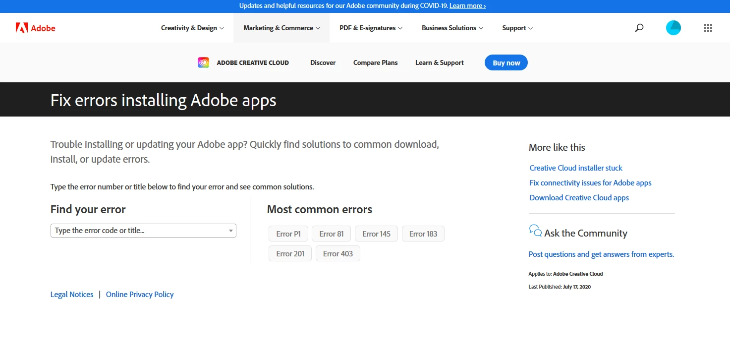

As for logs, I don't get any error messages in the client, it just freezes at some percent updated.  I don't see any guidance on where to find the logs outside the client.  I just see the following:
I don't get an error when the problem occurs.  The app will just say "Updating Creative Cloud" and progress until some percentage (which seems random) at which point it freezes.  When the updates work it takes less than a minute.  When it freezes I can let it sit for 15-20 minutes and see no progress.
