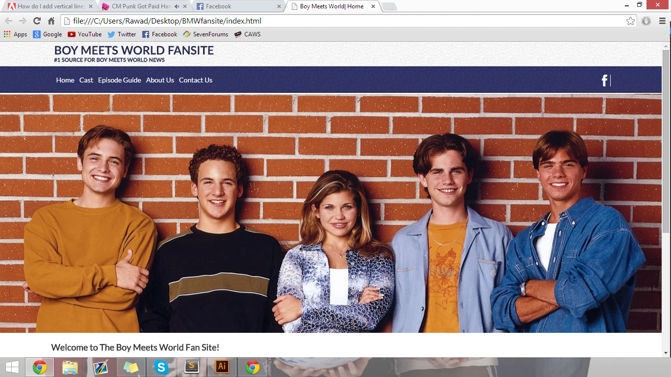

This is prob a very simple solution, however I never done it before, How would I be able to add Vertical lines between navigation labels. I tried to use Photoshop and save a line to a png but I'm sure there is a proper way to this solution. As always help would be appreciated.
Home|About|Contact|

I want the vertical line to go from top to bottom of the blue navigation bar
This is my CSS code
.Fbicon{
  background:url(../images/fbicon.png);
  width: 24px;
  height: 24px;
  float: right;
  margin-top:17px;
  border-right: 1px solid #fff;
November 30, 2014
The css for the icon is based on the dimensions of the icon. You could make a separate "|" to match the size of the nav  and position it after the fb icon.
