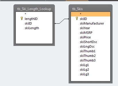

Ok got the DB figured out. I added a reference table for the skiLength like this
Now I believe that I need to creat a new table that will hold this info. so I can pass it on to the PayPal cart. Any thoughts?
