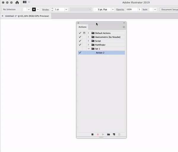

Here is video of adding script to action. Thanks guys for helping on this!
You are using the wrong way to add the script to the action. Add scripts via "Insert menu item".

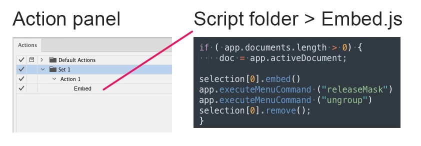

Tell us more about it. What happens on the screen, does an error show up? What version of Adobe Illustrator, Mac OS, Windows? Could you show us an example file? I added your script to a new Action and ran it on the linked EPS. The script executed. Illustrator CC 2019/2022, Mac OS.

Show a screenshot of your Action panel. Or you can record a video of you adding an action and calling it. I don't quite understand how you can see the individual script commands in the Action panel? Only the script file is added there.
