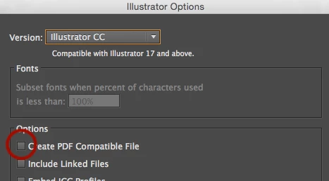

Mike_Gondek10189183
July 13, 2017
Yes the .ai half of your file must have become corrupted, and you are opened the pdf compatibility part.
If you save as your files and turn off pdf compatible the chances of this happening are greatly reduced. This problem used to happen a few years ago until i edited the adobe illustrator prefs to make PDF compatible OFF the default, on the networks I manage. This reduces my billing on service calls, but I get enough work so feel good about doing the right thing for my clients.
Now one could say this is dangerous to turn off pdf compatible as when the .ai half gets corrupted you have nothing. But after years of doing this am finding turn ing off pdf compatible almost eliminates corruption.
What happens if you open the file on CS6. Usually the corruption happens during the save process, but can happen during transfer to a USB stick for example.
