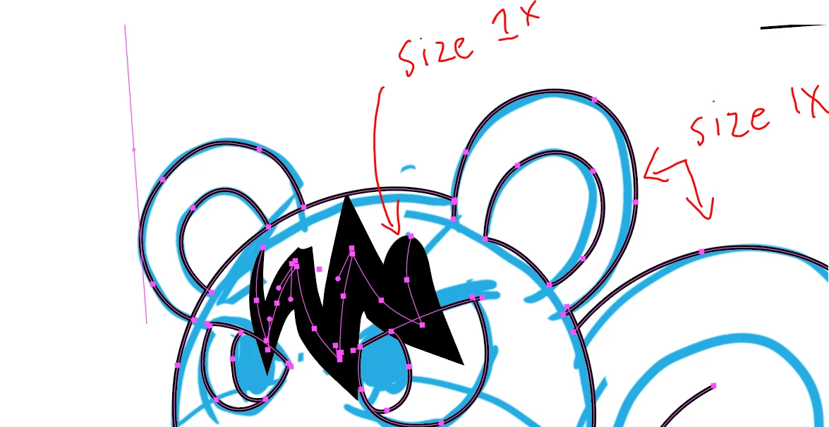

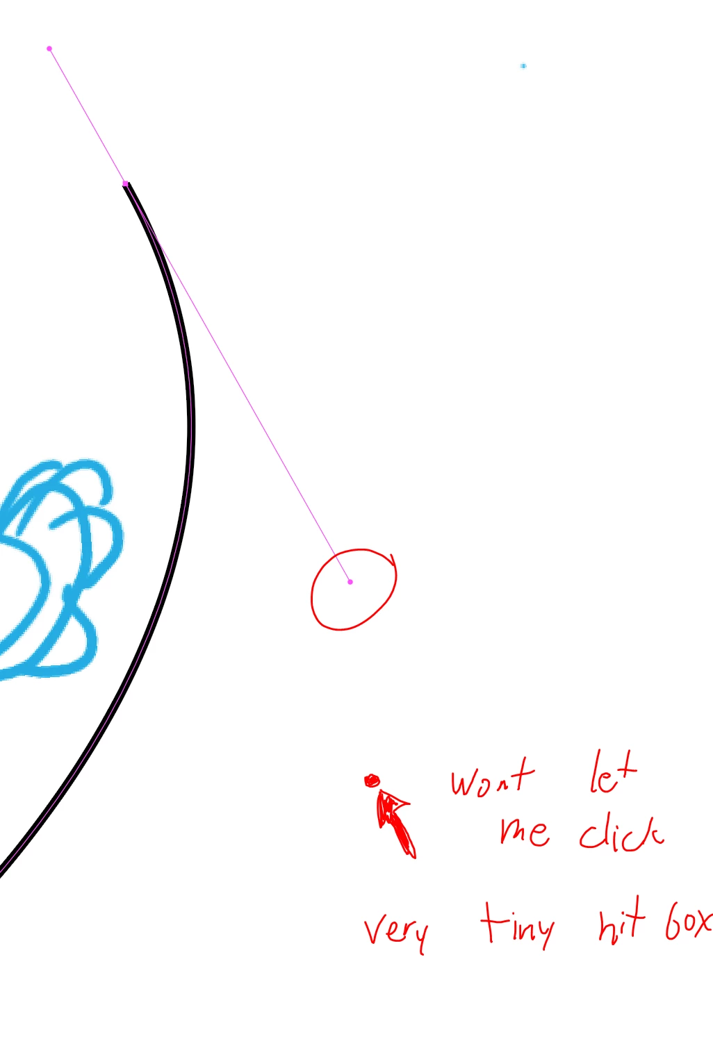

I'm having a hard problem in making line adjustments for few days. I am doing it on a cintiq. it won't me adjust the lines unless I really click that tiny dot to enable to move it. Is there a way to adjust to fix it?

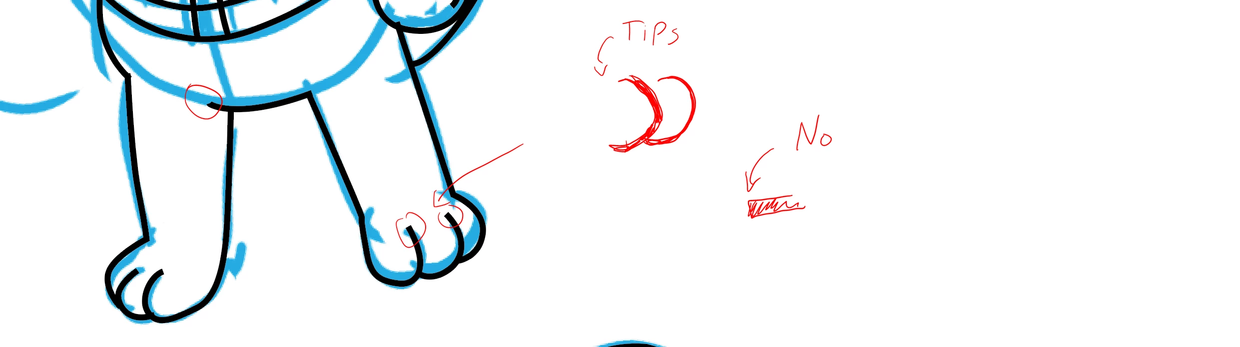

another annoying problem is the lines end and pressure. Even the costume brushes not help because when I change the size of the lines. It went bigger than the others. I've just selected size 1X.
How do I fix this problem?

You can increase the size of the handles by going to Preferences < Selection & Anchor Display and moving the Size slider from Default on the left towards Max on the right.
For the ends of the strokes, you can use the Width tool (Shift + W) to customize the line width.
