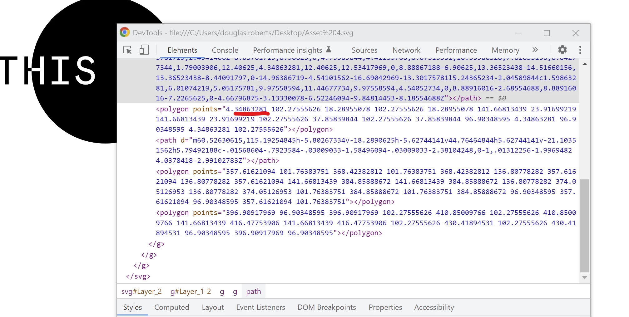

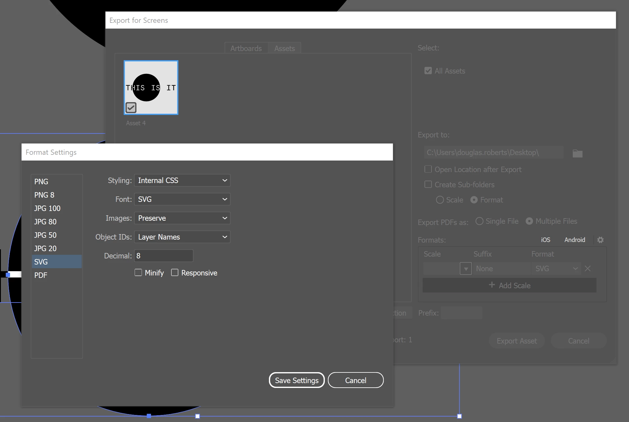

I don't seem to have any trouble setting more than 5 in Asset Export. I set 8 here and checked in Chrome:

It doesn't for me. This is the exported SVG in Chrome:
What OS and AI version are you using? Can you share a screenshot of your export settings?
