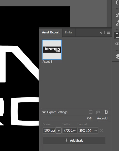

I have an group of paths (2 words (broken out to outlines), 1 icon) forming a logo.
When I either Group them and drag them into the Asset Export Panel, or Right click and export as Single Asset, the thumbnail looks great in the panel.  (white logo, black background).

Asset Export works in other files, so there is something about this set of assets that is making it do it...   but what???
