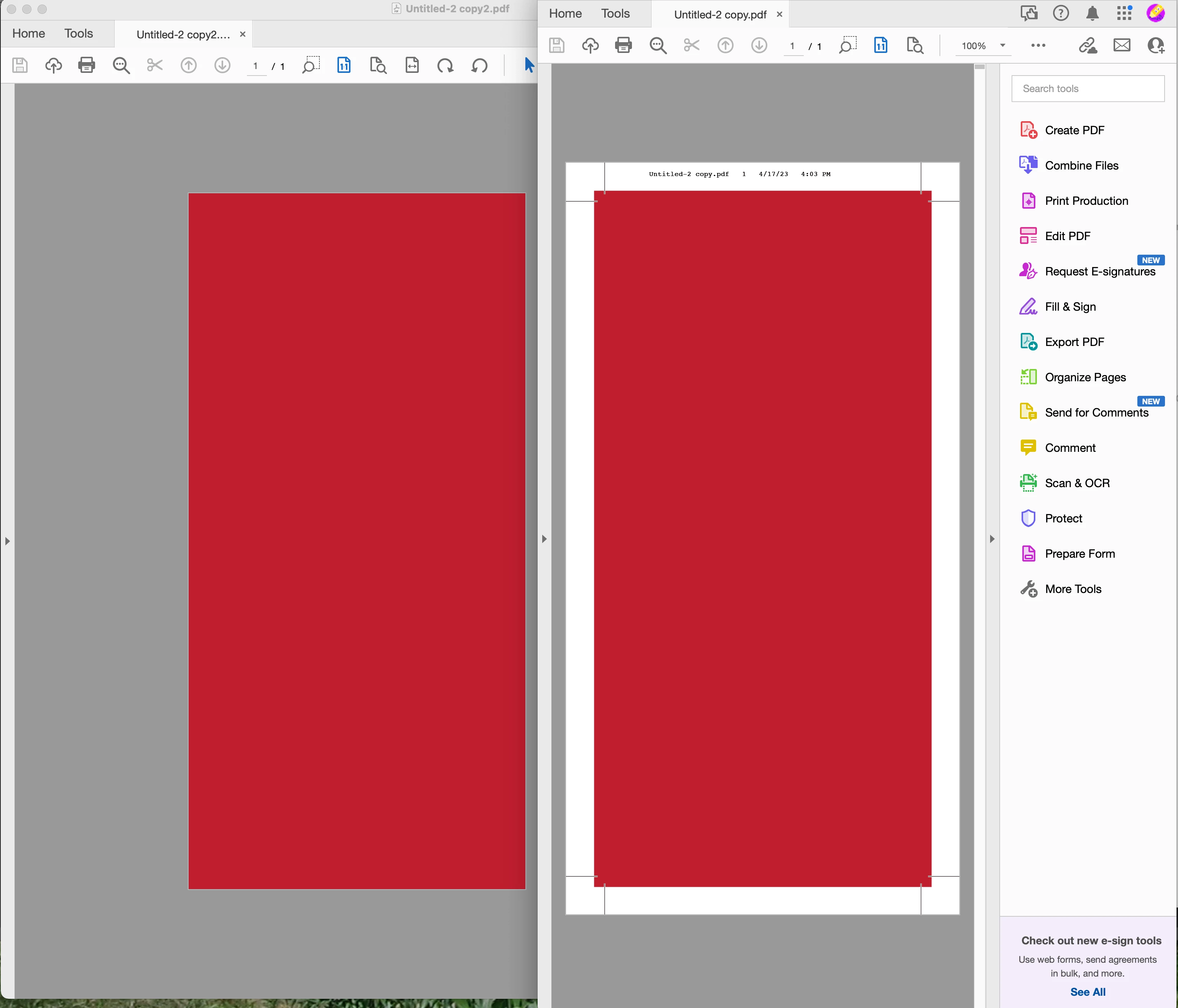

Apologies i'm a bit inexperienced when it comes to illustrator. I thought the same about the bleed, but my coworker that requested the files kept mentioning that there was a white outline around the file when exported and that I should remove it, which was only solved by excluding the bleed on export
April 17, 2023
If your co-worker does not want the white, then they will have to do without the crop marks (which may be how they need it - ask about this). Here are two files of the same size with the same bleed - they are both exported with bleed - the one on the left does not include any of the printer marks.
