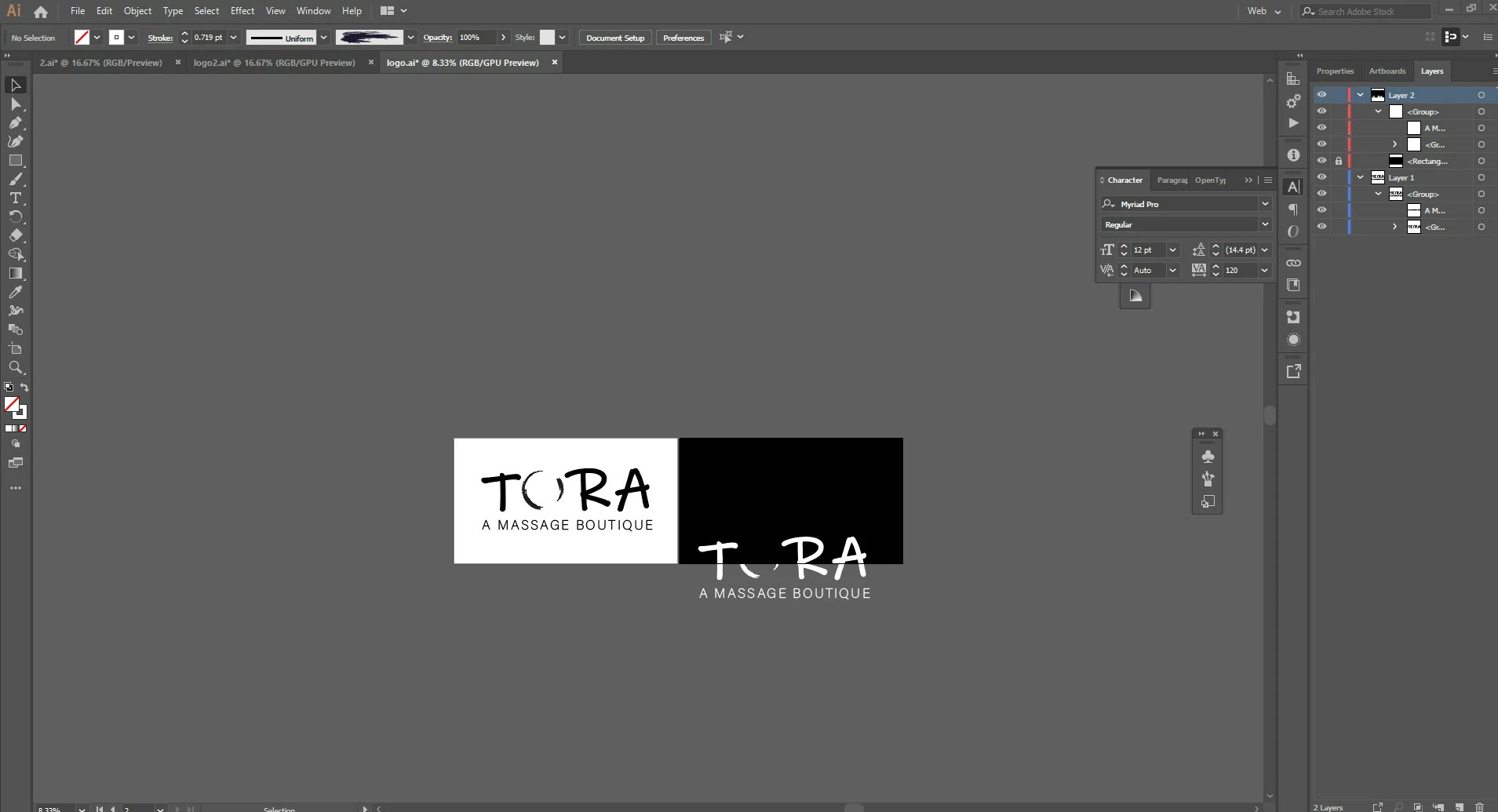

Hello, i created a brush, when i try to change it's color to white to a black background the brush path blends with the black background although it turns to white,
As you can see from the picture above the arrangement is correct, the icon is above the black background so this is not an issue.

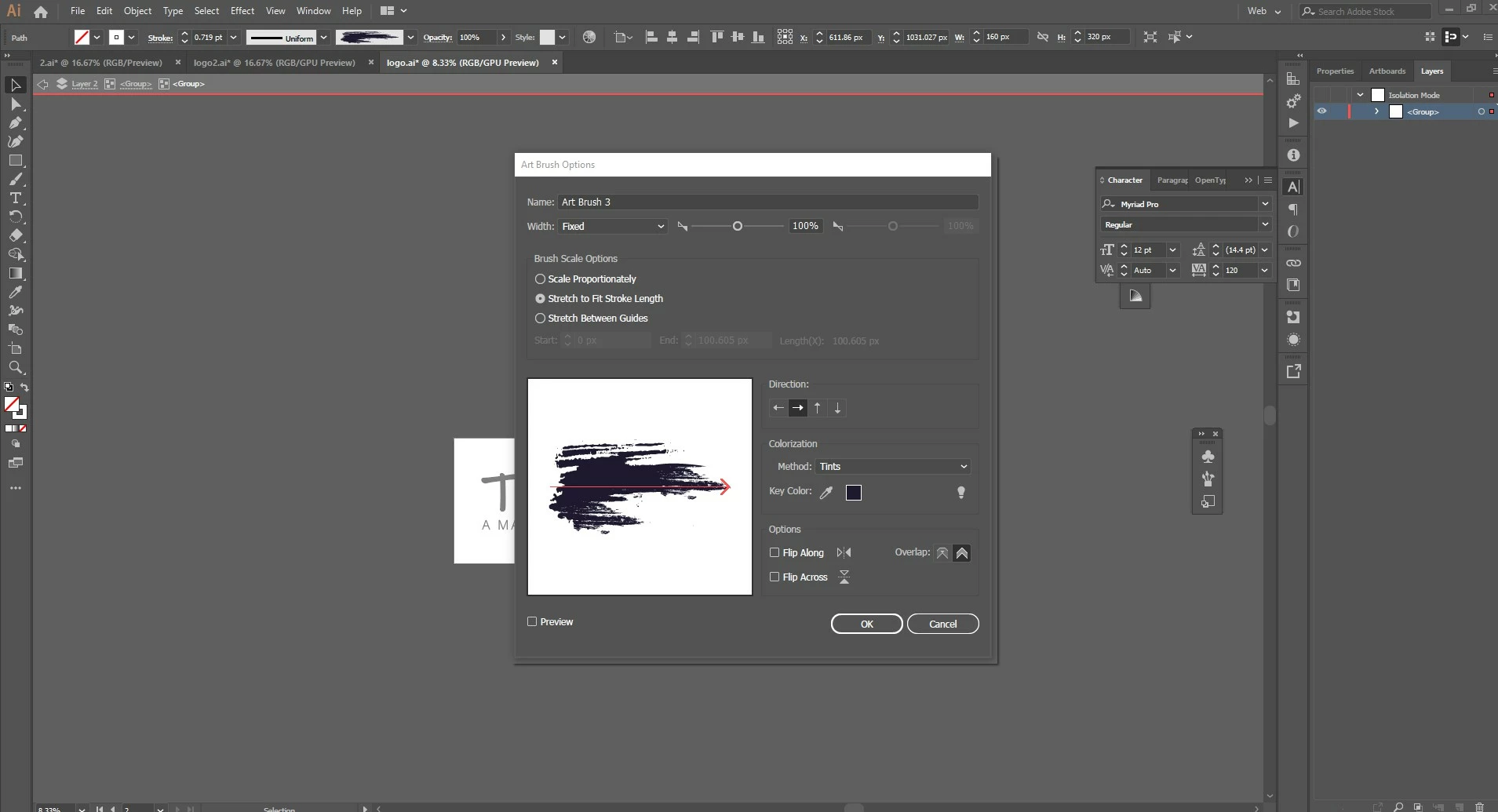

Also i think the options do not have any issues as i copied from other brushes which color changes at the same background.
What could be the issue?

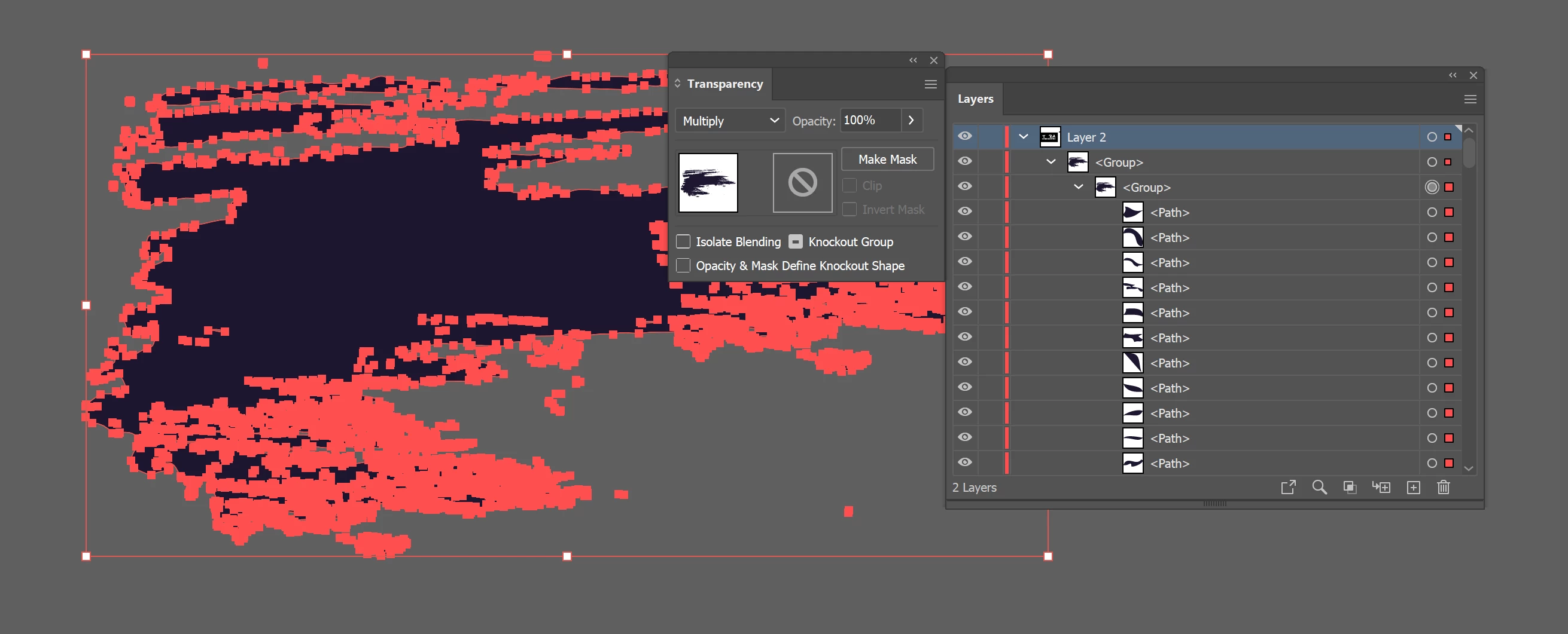

A nested group in the brush is set to Multiply:
Drag the brush from the brushes panel on to the artboard, set the group blending mode to normal, then drag it back over the original brush in the panel while holding Alt.

Somewhere deep inside the brush has been set to Multiply. I couldn't find out where.
Maybe drag the brush out of the brushes panel, and then assign the correct blend mode, color etc and create a new brush?
