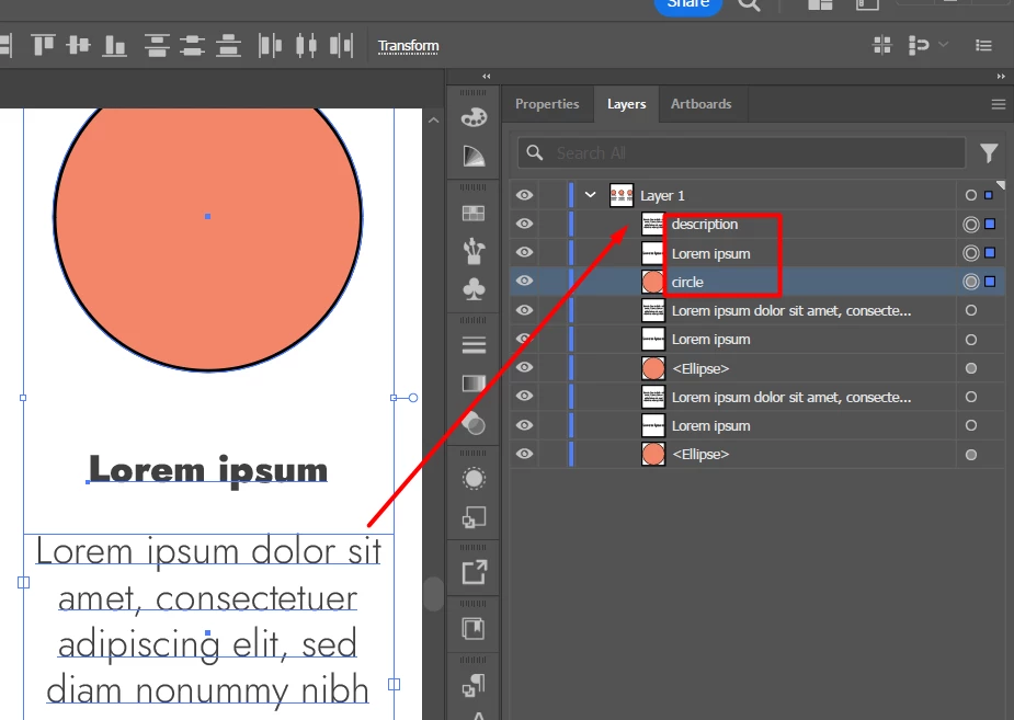

Helllo Friends,
is there a way to copy selected layer names (sub layers), by Script ?

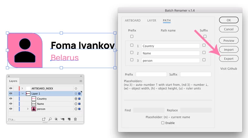

I also have an update to BatchRenamer v.1.4 where you can export object names to TXT instead of copying them to the clipboard.
