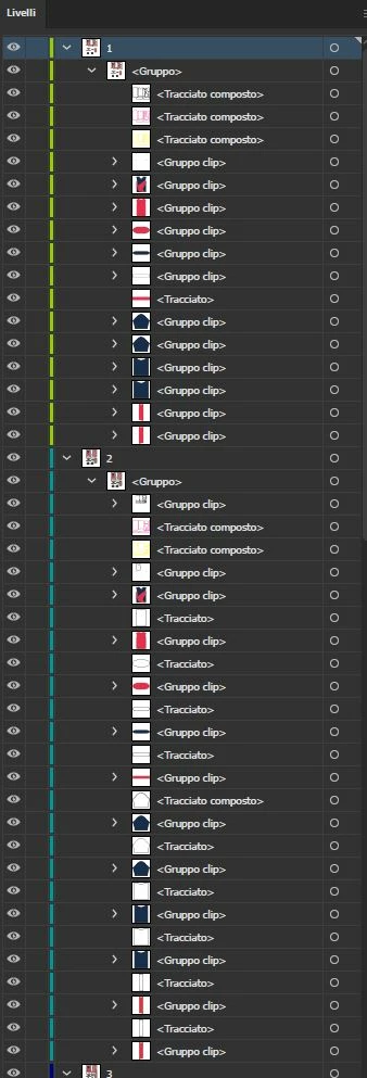

The problem is: if i import these eps in a new document and i embed them i'll have these unwanted outcomes:
- layers and items names are lost. I searched around and apparently there's no solution for this. Is it so?
- the quantity of items is not consistent on all layers, in some occasion some items are broken down in more part then in other occasion. Or, viceversa, some objects are clipped together.
- some items become compound path while in the original file they were group or clipping mask.
It all seems random, i can't get why this happens.

Here's a screenshot of my outcome:
Can anyone give a logic explanation for this?
I'm clueless.

Your EPS files have been created in Illustrator. Illustrator saved them with actually 2 files in them. The AI file for editing, which contains all the layers and effects and stuff. And an EPS, which has none of that. When opening your EPS in Illustrator, it opens the AI file. WHen placing it, it uses the EPS file.
Basically to get all the original layers, you have to copy/paste the content with "Remember Layers" turned on in the Layers panel.

It looks like you either copy and paste or you don't have layers.
Ton Frederiks
December 7, 2022
These .eps files were saved from Illustrator?
Looks like the pdf eps part gets used when embedded.
Opening them and Copy/Paste would be better.
Edit: as Monika said, the eps part is used.
