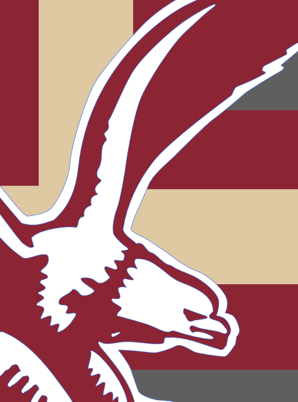

When I save from a standard vector format ai/pdf to svg, the conversion appears correct (see below)

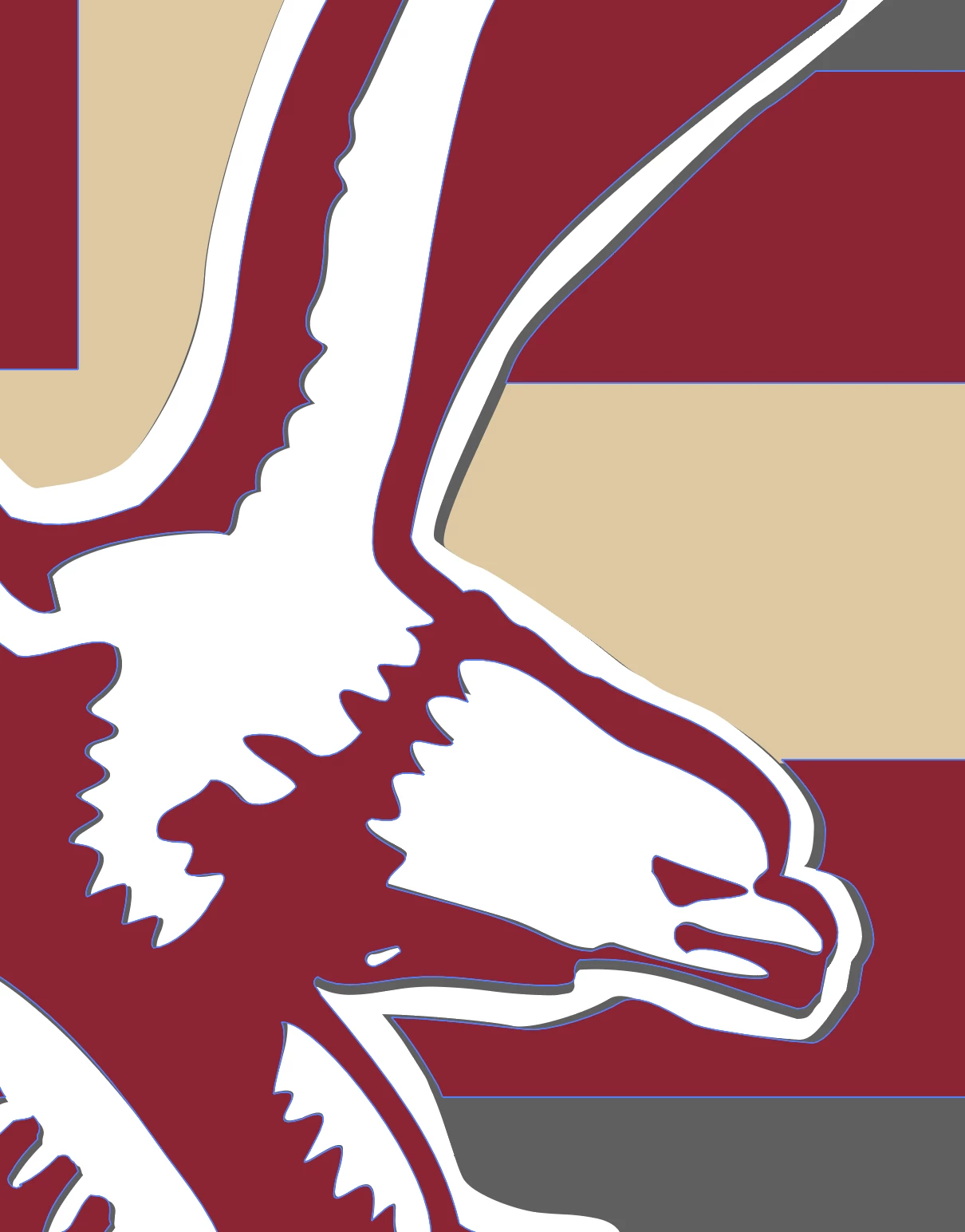

But when reopening the SVG file, there are small gaps that appear in the artwork, causing registration issues.
(see below)
What is causing this the happen? Is this related to svg passthrough precision?
How can I prevent this from happening again?

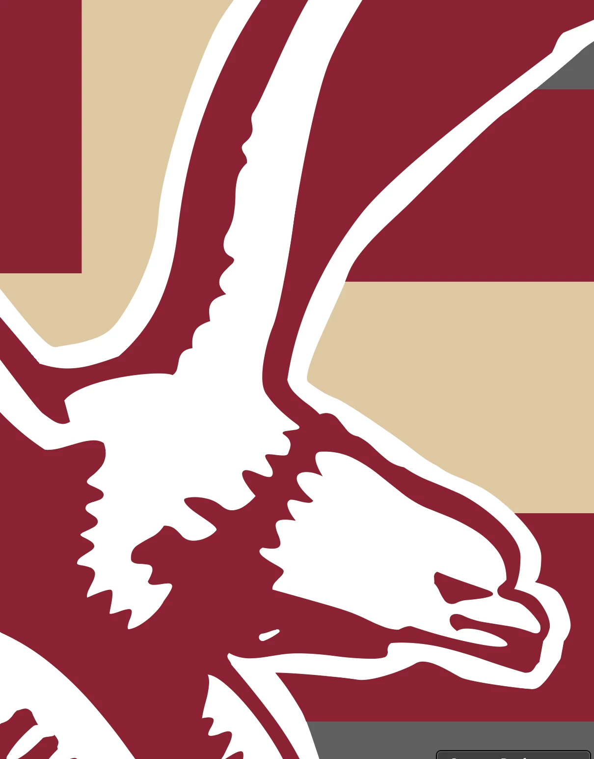

Correct answer mhuntr4
Just tested it at 5 decimals and looks corrected:

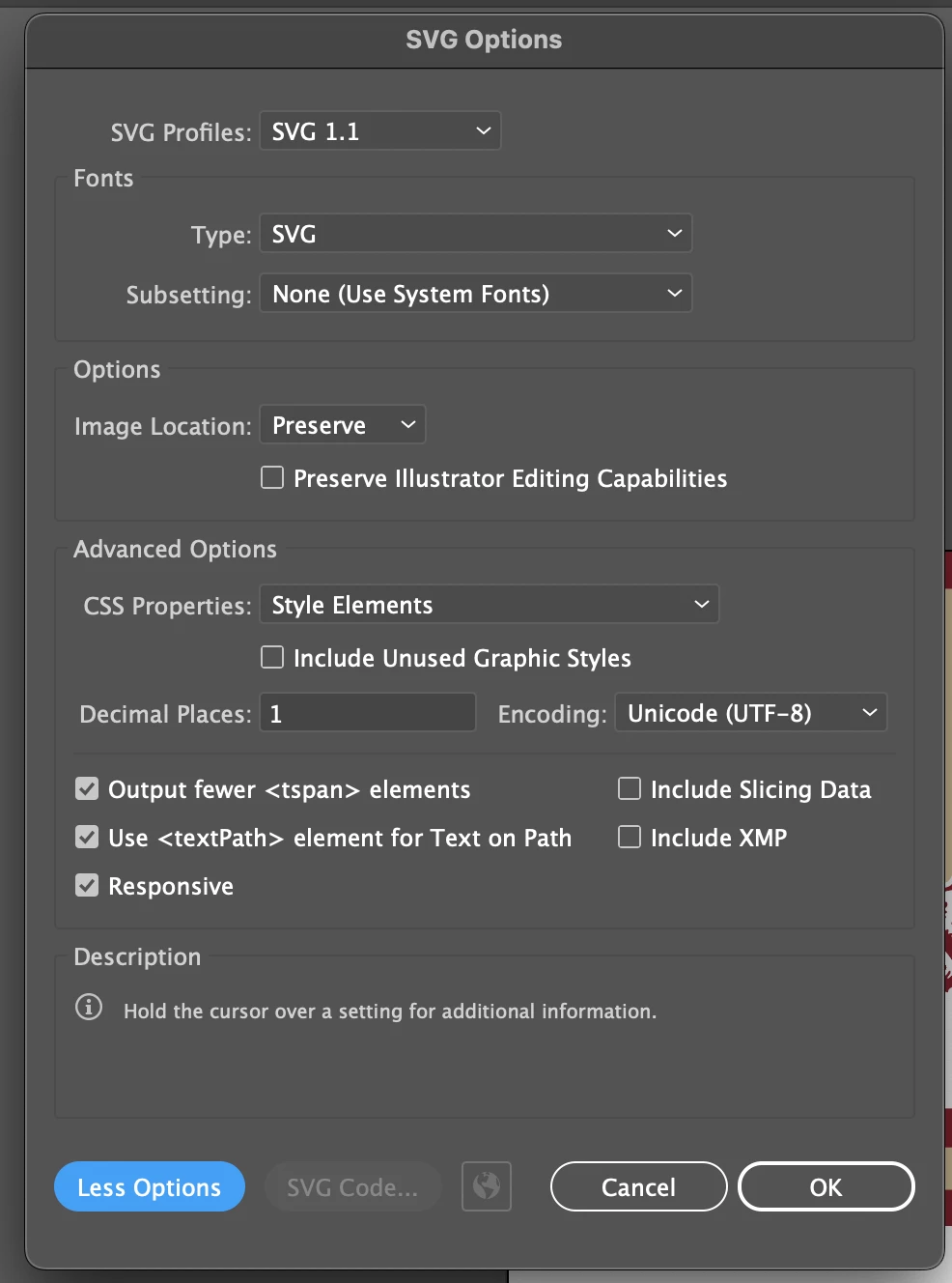

Which number is applied in "Decimals"?
mhuntr4Author
July 12, 2022
The artwork is small 44kb (needs to be small for our usage requirements)
Decimal points are set at 1
mhuntr4AuthorCorrect answer
July 12, 2022
