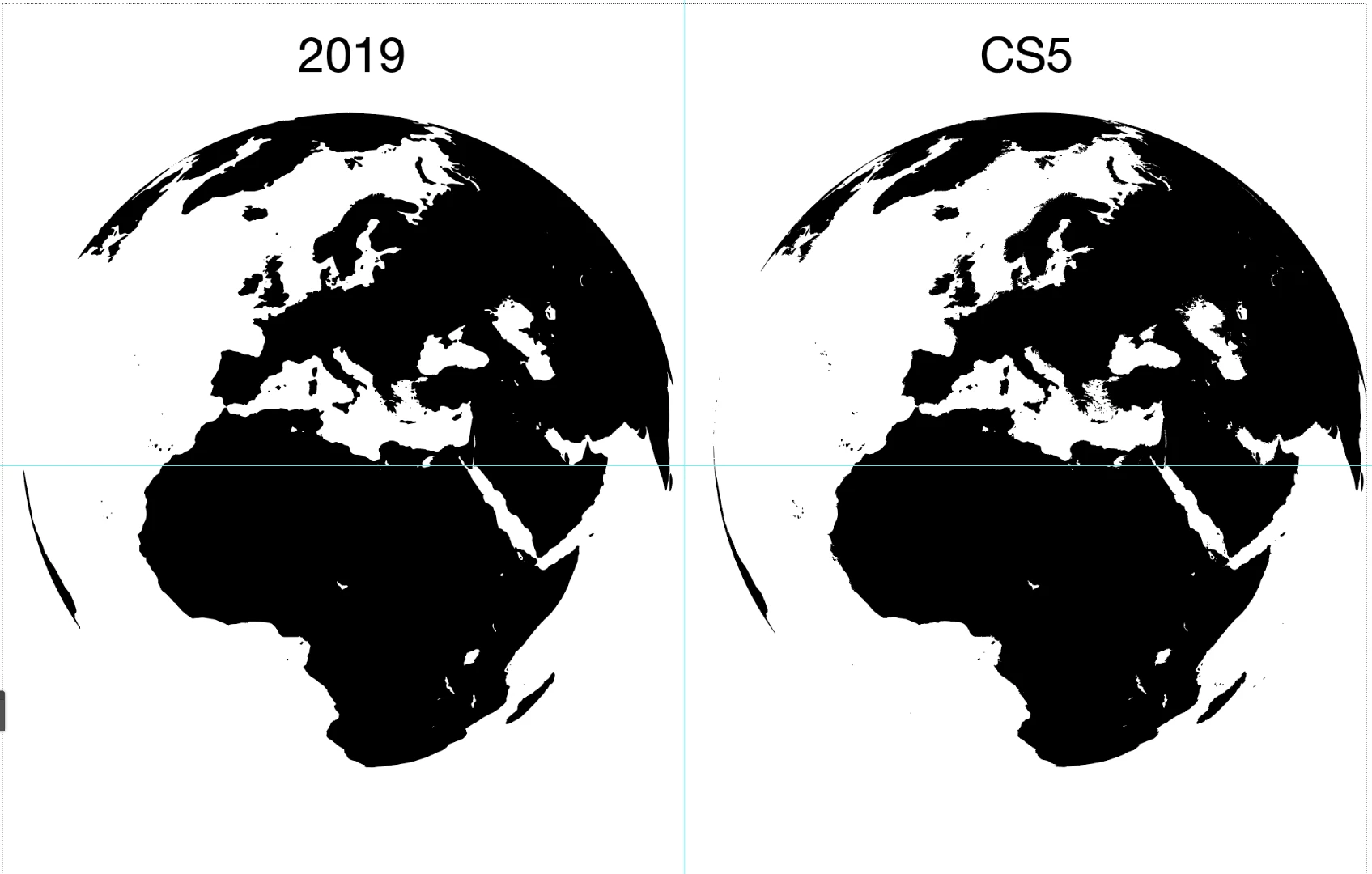

And this is a screenshot of the default tracing result (B&W, ignore white). If you could see it at size, it is OBVIOUS CS5 is FAR SUPERIOR in retaining fine details.
Yes this is a known issue. You might want to post it on http://illustrator.uservoice.com. Most probably there is already a thread on it.

As a test, I opened AI CS5, and successfully traced the same art there, and got a HUGE improvement in fine detail. The result is totally acceptable!
You can't COPY the paths into AI 2019, but you CAN save the CS5 file and open it in AI 2019.  :+)
One thing CS5 has that 2019 is missing is a control to adjust the blurring. I left it at its default of 0. Also, "ignore white" is also there!  :+)
CS5's tracing is INFINITELY SUPERIOR to 2019's!  (My only test so far is for pre-scanned B&W artwork only, so far.)
This really requires that AI 2019 developers NEED to go back to what CS5 made possible, and BRING it FORWARD!  As OS versions move forward, CS5 may not work for much longer. (In MacOS, I got a warning that CS5 needs to be "updated." But the app does still run in MacOS 10.13.6.
