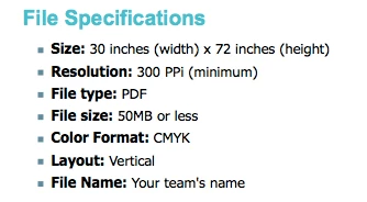

In Illustrator I am trying to export a banner for printing. The requirements are: 30x72in, CMYK, >300ppi, PDF.
The problem now is that if I want to save my file (preset: 30x72in, CMYK) as a PDF I can not set the ppi number.
Normally i should get around 12.000x28.000 pixels.
But it exports the document always with 2160x5183 pixels.
If I try to preset the document with the pixel number from above it doesn`t work, because it is to big.
What can I do to get around this problem ???
Thank you

    "The requirements are: 30x72in, CMYK, >300ppi, PDF."
    A banner at 300ppi?  Here's what I do:  Set the document size to 25% of 30x72 ( 7.5 x 18 ); place the image using 300ppi at the reduced size > Set the Rsster Resolution to "High" > Save As PDF ( High Quality Print ).  Tell the geniuses at the print lab to enlarge the file 400% in the RIP.

    to jdanek: These are the specifications for the file I have to send. They don't say more than this.
    Okay, as a conclusion: I can save my vector graphics as a PDF and they are scalable for them to the right size of 72x30 inches ?
