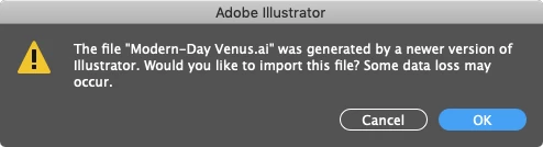

Are 2020 and CC 2019 installed on the PC?
If the file is saved in 2020 format, the layer will be flattened when opened in CC 2019.
Did you get this warning when opening the file?
--Susumu Iwasaki

I am having the same problem and I got that pop up aswell. Is there anyway to fix this?

Hello @Paige265475805xbu,
Sorry to hear about this experience. Would you mind checking if you have multiple versions of Illustrator installed on your computer? If yes, kindly remove the older version and check if it helps.
If the issue persists, kindly share a few more details, like the exact version of the OS and Illustrator installed on your computer, so that we can investigate this further.
Looking forward to your response.
