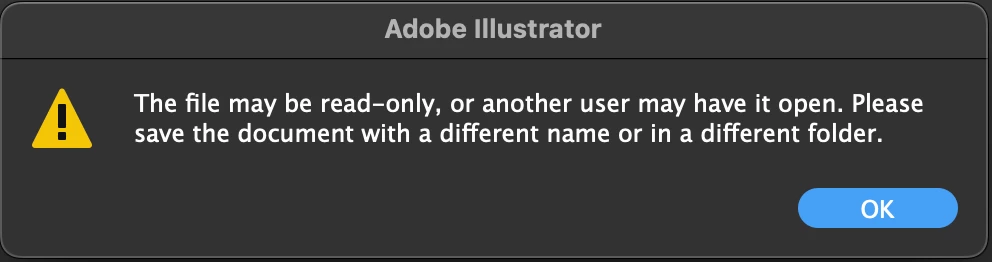

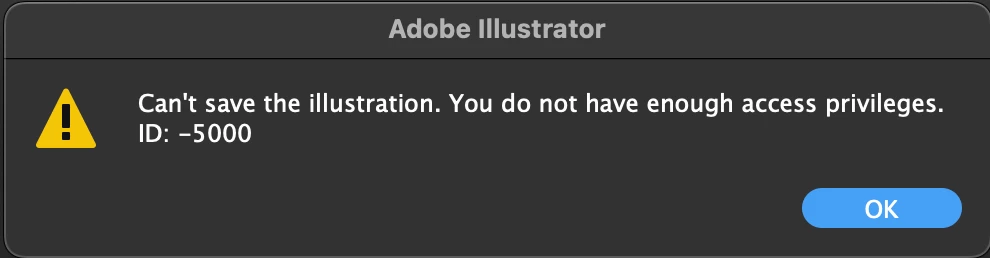

Since the update V26.2.1 this morning, I have not been able to save directly to my external hard drive. I have to save on my mac and then drag it into the hard drive manually, this is highly frustrating. Also when I open a file from the harddrive it loses all links and have to relink them.
