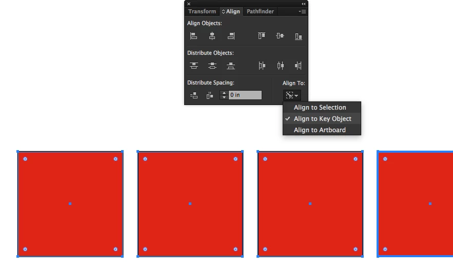

Jeff Witchel, ACI
July 21, 2016
I'm assuming that you wish to measure the distance to make that measure a certain amount. If that's the case, why not just use the Align panel to make it that precise amount?
  1. Select two or more objects that you want to be an exact distance apart.
  2. Click again on the object that is already in the correct position This will make that object the "Key Object."
  3. If the bottom third of the Align panel is not showing, look under the Options menu of the panel and choose Show Options.
  4. In the Distribute Spacing section at the bottom of the panel, type a measurement in the field.
  5. Click either the Distribute Vertical or Horizontal Space command and your object will now be that exact amount apart.
Hope this helps! Please see attached.

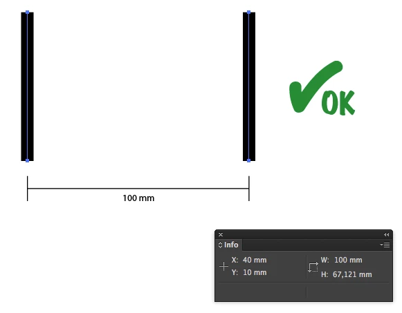

July 21, 2016
I used the info panel to read the measures between two lines. It worked fine till CC 2014 and it was accurate.
Now with CC 2015 / 2015.5, is different: the info panel shows the distance between two lines including the stroke weight in the measurement, therefore if I change the stroke width the measure will change.
How can we measure the distance without adding the stroke weight as it worked with past Illustrator releases(like CC 2014)?
Monika Gause
July 21, 2016
In the Preferences > General turn off "Use Artwork bounds"
