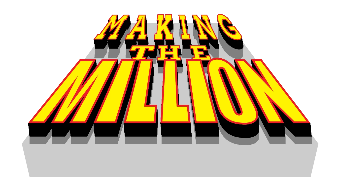

I'm working on a project and so far have made it here

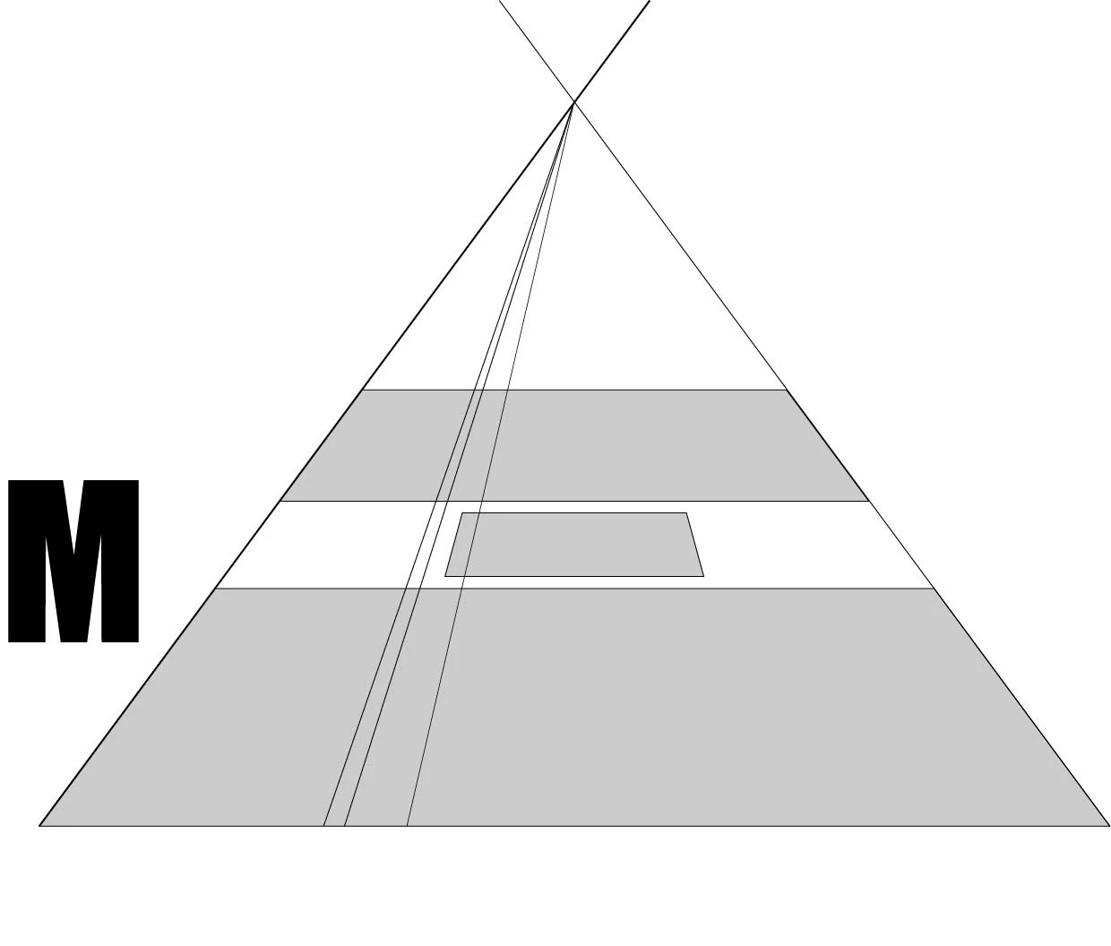

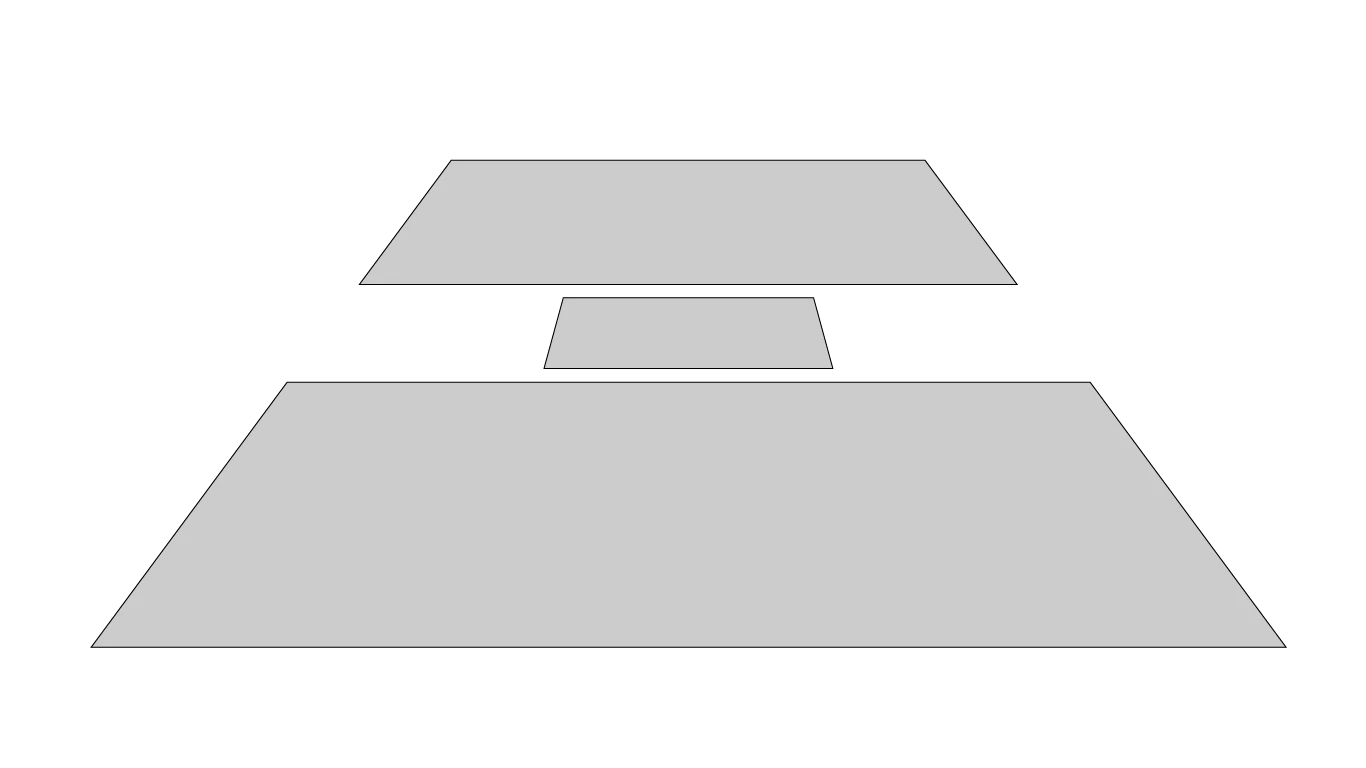

I followed this tutorial to get the text in that perspective. Basically what I did was created the grey platform, and cut up the top into three sections for each word to fit.
I typed out the words and selected object, envelop distort, make with to pobject. I eventually got to the first image above. But somethings bothering me.  The M and the N (first and last letters in million) are too squished horizontally and by my eye I think they should be much wider and take up more space than the middle letters. I would also like to have less space between the letters in "making" and "the". Basically I want to stretch the letters horizontally, independently, but still retain the perspective.
Problem is I don't know how to do that and have been trying different methods to do so. After getting the words into perspective I created outlines of them so they were no longer text objects. So then I could freely manipulate the shapes but the perspective wouldn't "stick" and I would maybe have to eyeball where the points and angles of each letter should go in perspective.
One thing I just tried that I was sure would work was to break up the perspective box into individual spaces and do the process for each letter individually.
but when I do, the letters are wacky
