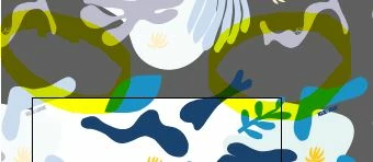

What I mean is that when I go back to the original artwork, the create pattern option results in different outcomes everytime. I would expect it to be the same all the time.
When I close the gaps, as shown below and I close the pattern view, next time I make a pattern out of it, I have gaps somewhere else. Was expecting it to be correct once I fixed it. Apperantly it will only stay the same as a swatch.
Next step would be to create a printable file from this... so the parts that are cut off, should be shown on the other edge from where they were cut of on the first edge. Is there a proper way to do this, other than apply the swatch to some background and try to crop this artwork on the right place and see if it turns out OK? Have been searching the internet for it, but could not find it.

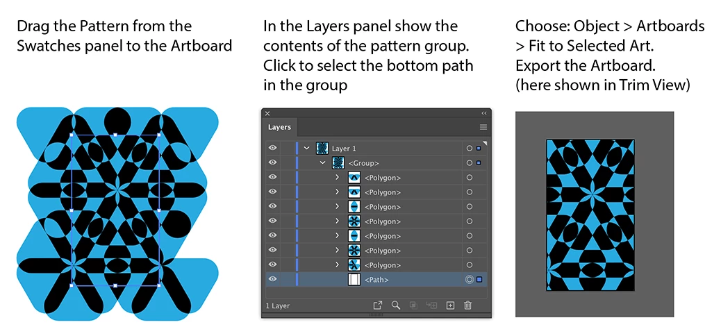

If you double click the pattern swatch in the Swatches panel, you should get the same as when you created it.
If you want a single pattern tile, drag the pattern swatch out of the Swatches panel an use the bottom rectangle to set the size of the artboard.
