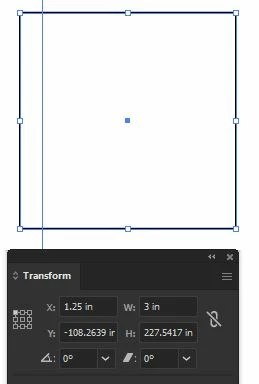

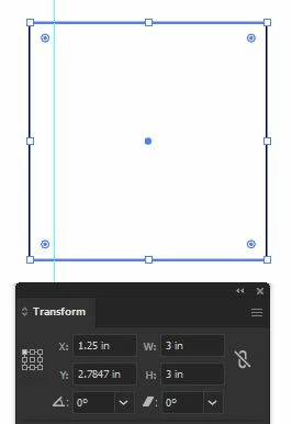

January 31, 2023
Square selected, square and guide selected...

January 31, 2023
Are you sure you didn't select an invisble item or a guide?

January 31, 2023
Is Vthe Bounding box visible? It shows you the scope of the selection. You can't move the bounding box past the canvas bounds
