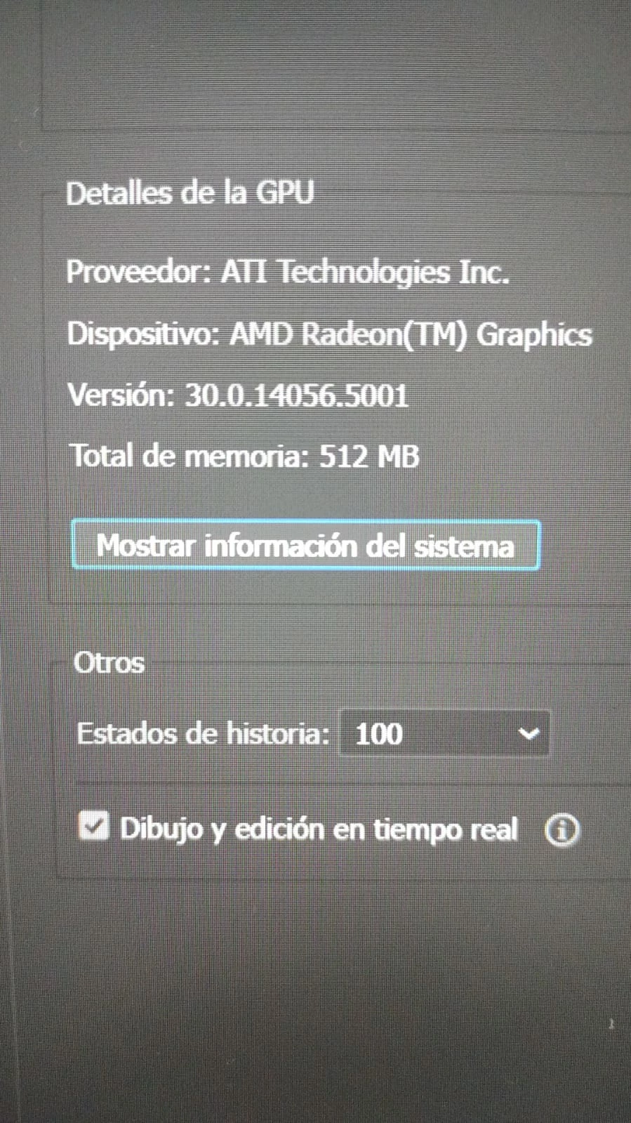

Hola! como andan?
Acabo de comprar una compu y al instalar Illustrator, me dice que el GPU es incompatible y estoy teniendo bastantes problemas para solucionarlo.
Dejo imágen de las especificaciones, agradezco cualquier tipo de ayuda que me puedan brindar
Muchas gracias!
Que tengan lindo dia

Hello @Micaela27914255rwf7,
I understand that you're having trouble with Illustrator due to a GPU compatibility issue. I see that you have checked your system specs, but Illustrator requires at least 1 GB (1024 MB) of VRAM (Video RAM) to function correctly. Your system, as shown in the screenshot, seems to have an integrated GPU with 512 MB of VRAM, which may be causing the issue.

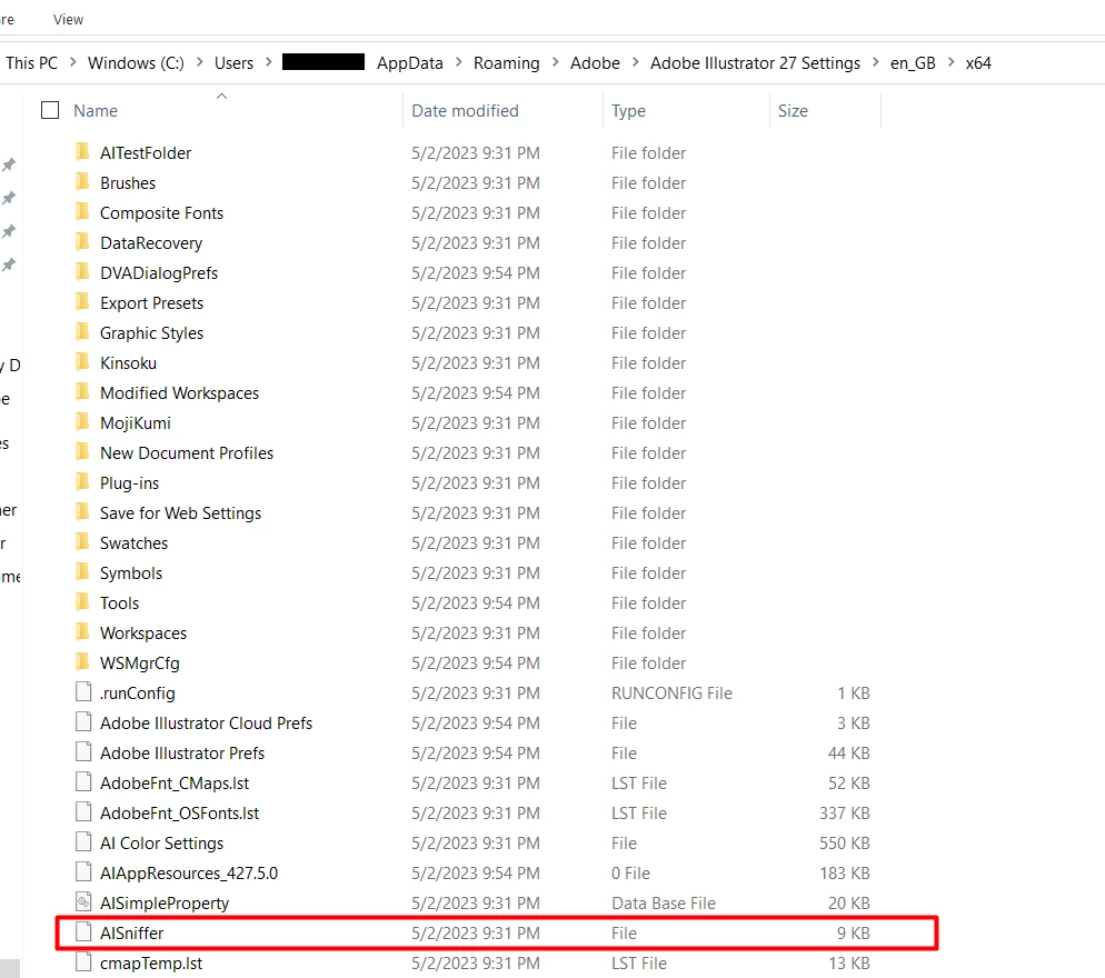

However, to further diagnose the problem and see if there's any potential solution, the product team has requested the "AISniffer" file from your system. Please locate and share this file as requested:
  • Navigate to the following folder on your computer: C:\Users\<username>\AppData\Roaming\Adobe\Adobe Illustrator 27 Settings\<locale>\x64
  • You should find the "AISniffer" file in this location.
This information will help them understand your system configuration better and further investigate this.

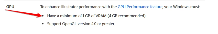

kglad
October 4, 2023
check the specs, https://helpx.adobe.com/illustrator/system-requirements.html
<moved form cc desktop>
October 4, 2023
i have all that specs 😢
kglad
October 4, 2023
double check your vram.
