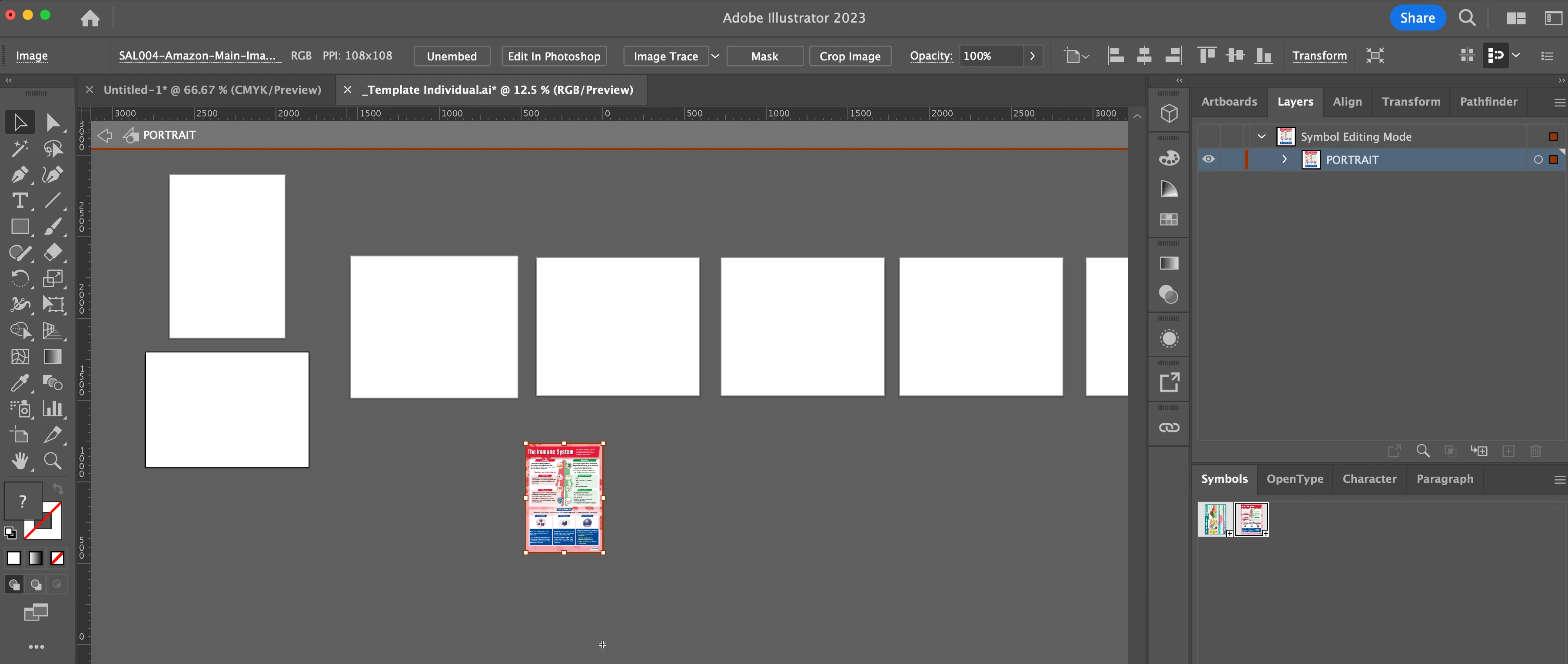

2) Create Main Image by replacing linked .ai file - as shown to the left of Image 1
  • script recognises orientation of .ai file chosen by user
  • export for screens the Artboard with correct orientation
3) Create Marketing Images using recently exported Main Image
  • orientation is remembered and keeps appropriate layers hidden
  • Symbol is amended
    • orientation
    • object within symbol is relinked with recently exported Main Image
  • export for screens all marketing artboards
(Image 1 - Main Images of the left, marketing images on right)

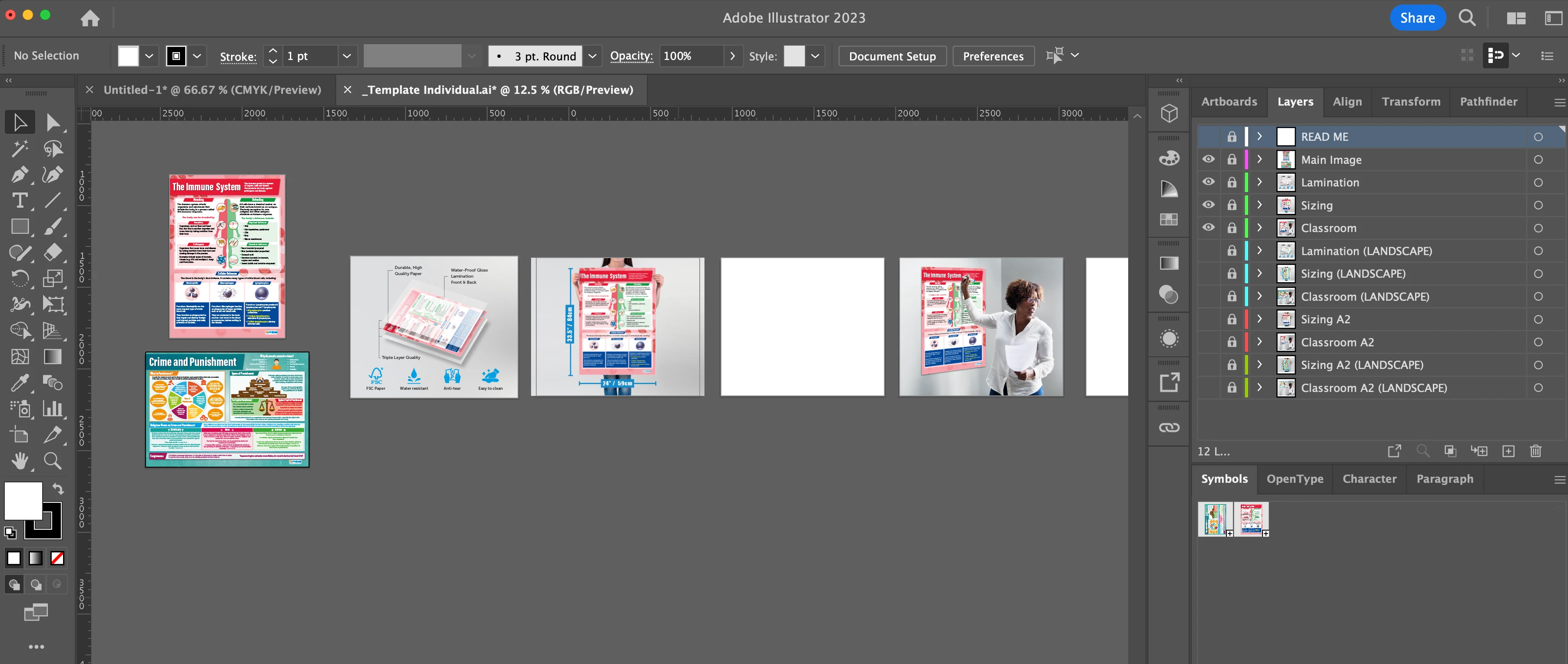

I tried going from another angle to relinking all images at once through symbols. So far it has worked where I manually relink and embed the object inside the symbol, so that all instances, even those envelope-distorted, are updated. However, when transferring this to JavaScript, i can't see any way of accessing the objects within the symbol object, but even if it is manageable, the same problem arises where there's no ability to relink a pluginItem.
(Image 2 - Replacing linked image in symbol)
