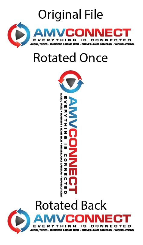

I have a design with a gradient that I need to rotate to fit on our print media.  I can not expand because the gradient will become a clipping mask with all the sections of colors and I need to make a cut line.  It's impossible to create the cut line after expanding.  This issue, that I've never seen before, is that when I rotate the design, the gradient does not rotate with it.  Oddly, it won't rotate with it but, when I rotate it back, it does. I can not nummericly change this because there are too many gradients at different angels and the angles are not round numbers.  How do I fix this?

You have seen Illy (job description Adobe Illustrator) move in mysterious ways, so you can try to work with them, such as rotating the other way and/or in multiple steps, to see whether you can get it right by the ways it gets itself wrong.
You could also try to see whether you can create a (wrongly) rotated gradient (such as 90 degrees anticlockwise) that will be right when rotated.
Or you can apply the ailing gradient after rotating.
Have you tried to remove the gradient and reapply it, then rotate?
There may (also) be other ways to accomplish it, depending on how the AMVCONNECT part is created.
Apart from everything else, live Effects fail to rotate.

As far as I can see, the issue only applies to the (first rotation of the) AMVCONNECT.
I believe some kind of corruption is a possibility.
What happens if you create a new document and copy the artwork over, as a whole or in in different parts (just select and Ctrl/Cmd+C and then Ctrl/Cmd+F)?
Or you can try to recreate the AMVCONNECT part.
J2kLarsonite
December 10, 2020
Same thing. The image was just that. Copied and pasted out of the design
file and into a new file. It happened again with a gradient from white 100%
- white 0%. I'm not sure why the gradient doesn't rotate when rotating the
entire graphic. But it's even weirder when it doesn't rotate one way but
does another way. I was thinking it would be a setting like enlarging a
graphic with a stroke. I know there's a setting to choose either way. But i
don't see a setting for the gradient rotation.
