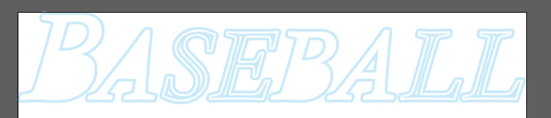

Hey Everyone,
I've been trying to write a script to remove the inside paths leaving the needed ones behind, but I can't get it quite right...

it seems like the lines are multiples of 3. Holes are on top, outside lines are at the bottom
- if count == 3, keep 2
- if count == 6, keep 0, 5
- if count == 9, keep 0, 3, 8
that should cover 0, 1 and 2 holes, it doesn't account for characters like i
m1b
February 14, 2023
@BryanPagenkopf I'm a bit stumped by this one. It is harder than you might think. I would love to see someone solve it.
If you need to resort to manual methods, then PathFinder Unite does a good job immediately. But the PathFinder options we have available via the scripting API don't seem to do what the normal PathFinder does in this case. The project is complicated by the stroke aligned with outside path perhaps.
- Mark

February 14, 2023
I'm not sure why but I am getting mixed results with your script @femkeblanco
The 2nd "A" turned out how it should 🙂
femkeblanco
February 14, 2023
Unfortunately, I can't open your file (because of my version of AI), but I presume the result you get is because of the anatomy of the items.  For example, the path item that makes the "hole" in the A may be the topmost path item in the second A, but not the first A.
