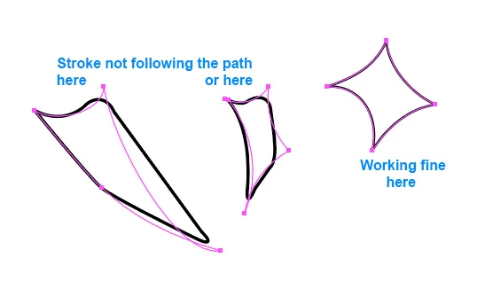

I have an annoying problem that my stroke does not follow the path.It occurs when using the pen tool and also with the pencil tool. The problem is also inconsistent. It works as expected sometimes and not others. It can be seen in this screenshot which shows two with the problem and one without,  all drawn at the same time with the same settings.

Probably you have some effect set up, which affects the strokes you draw. You can select the path and then open Window > Appearance to check it out.
Then also the setting "New Art has basic appearance" when turned on will keep your new paths clear of any effects.

I don't know why but clicking the default style in the styles menu seems to have solved the problem. Would be interested to know if anyone can explain why this worked.
