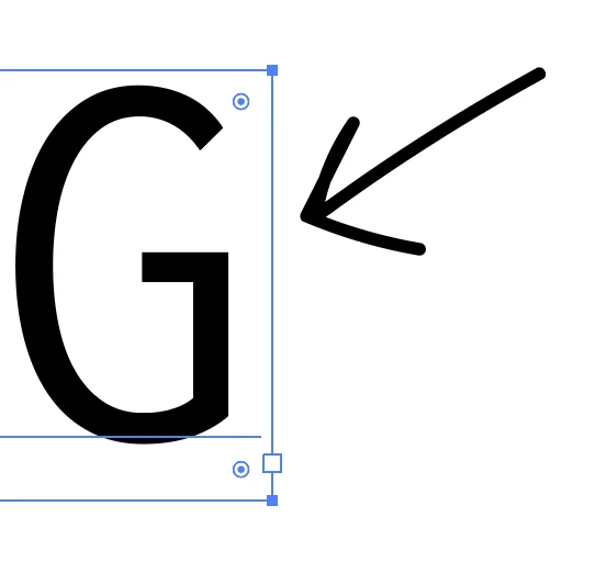

Hi all. I was wondering if someone could help as I am really struggling with this. I am making a logo, and I need to align two titles, one on top of the other. However, my problem is that there is a space between the end of the text and the text box, which I cannot seem to control. This is annoying because when I align the text, it is obviously considering the gap at the end of the text box. Therefore, it is never really aligned properly I was just wondering if anyone had a solution. Thank you

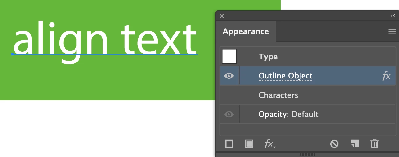

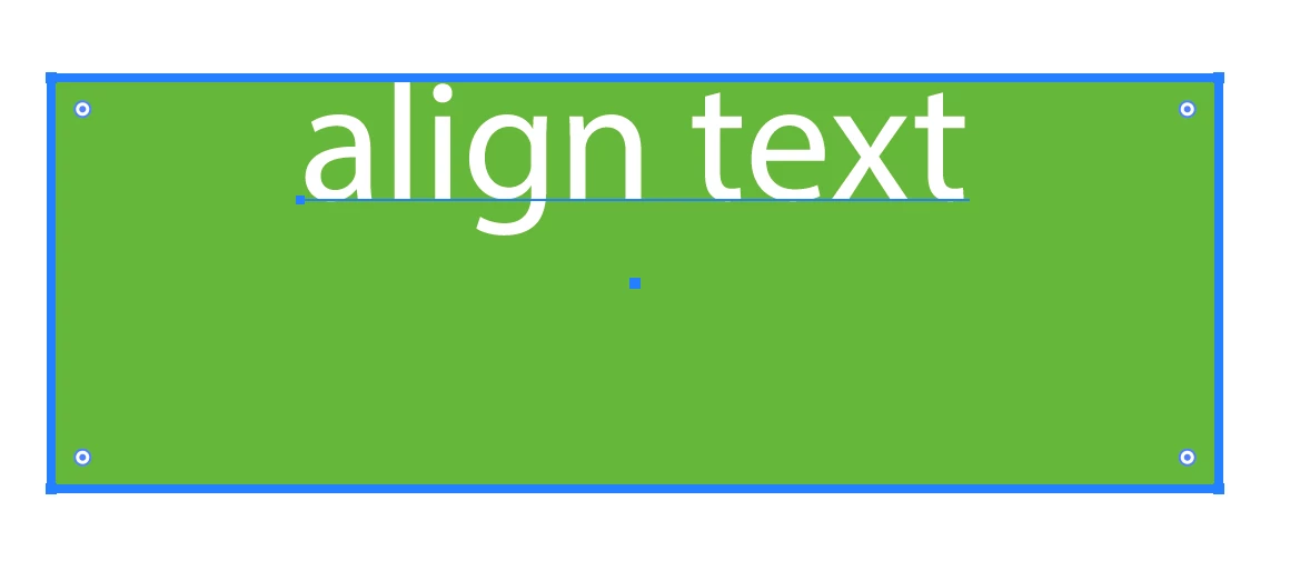

Try this
1. Go to preferences and check "Use preview bonds"
2. Select your text with the selection tool
3. Go to Effect - Path - Outline object
4. Now you can use the align panel to align as you want even to a guide, the text keeps editable and you can disable  the effect at any time, no need to convert to outlines

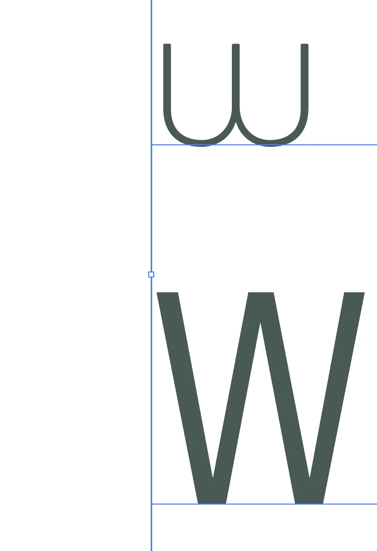

Hi John, thank you for your response. I gave your idea a try. However, there is a gap at the start of the text as well as shown in the screenshot. I understand this might just be down to my choice of fonts, but I just wanted to see if anyone actually had a solution. Thanks again.

This happens because of the particular font. The width of the letter is built into the font. You could set the cursor to the left of the letter and then enter negative tracking to move a letter (and the foloowing ones as well) to the left
