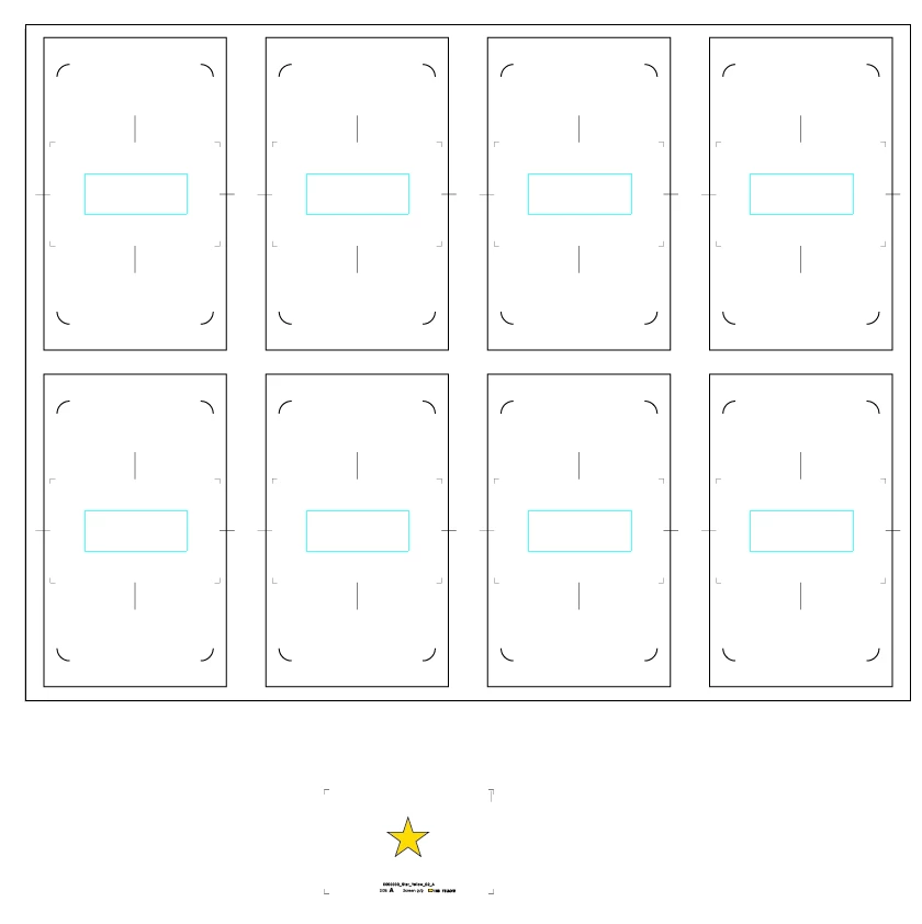

What I would like to do is have the JavaScript take the group item which is on a specified layer and move it on the artboard to a specific xy location.
In the test .ai file I have attached, I would like to take the group item in Layer 2 and move the group to the upper left corner in the document on the same layer.
The screenshot shows the group item at the bottom of the screen of the yellow star. I would like to move this whole group to the upper left corner into position on the document.
I am guessing that my code is trying to move the layer in the palette rather than the items on the layer.
