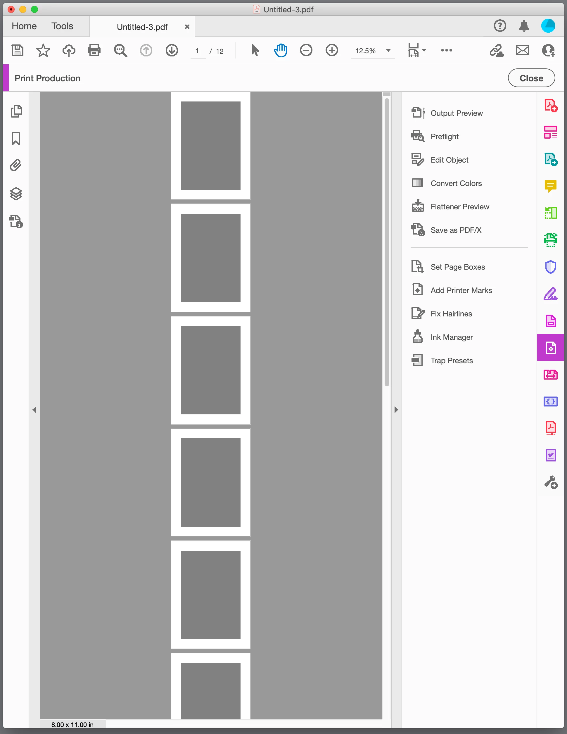

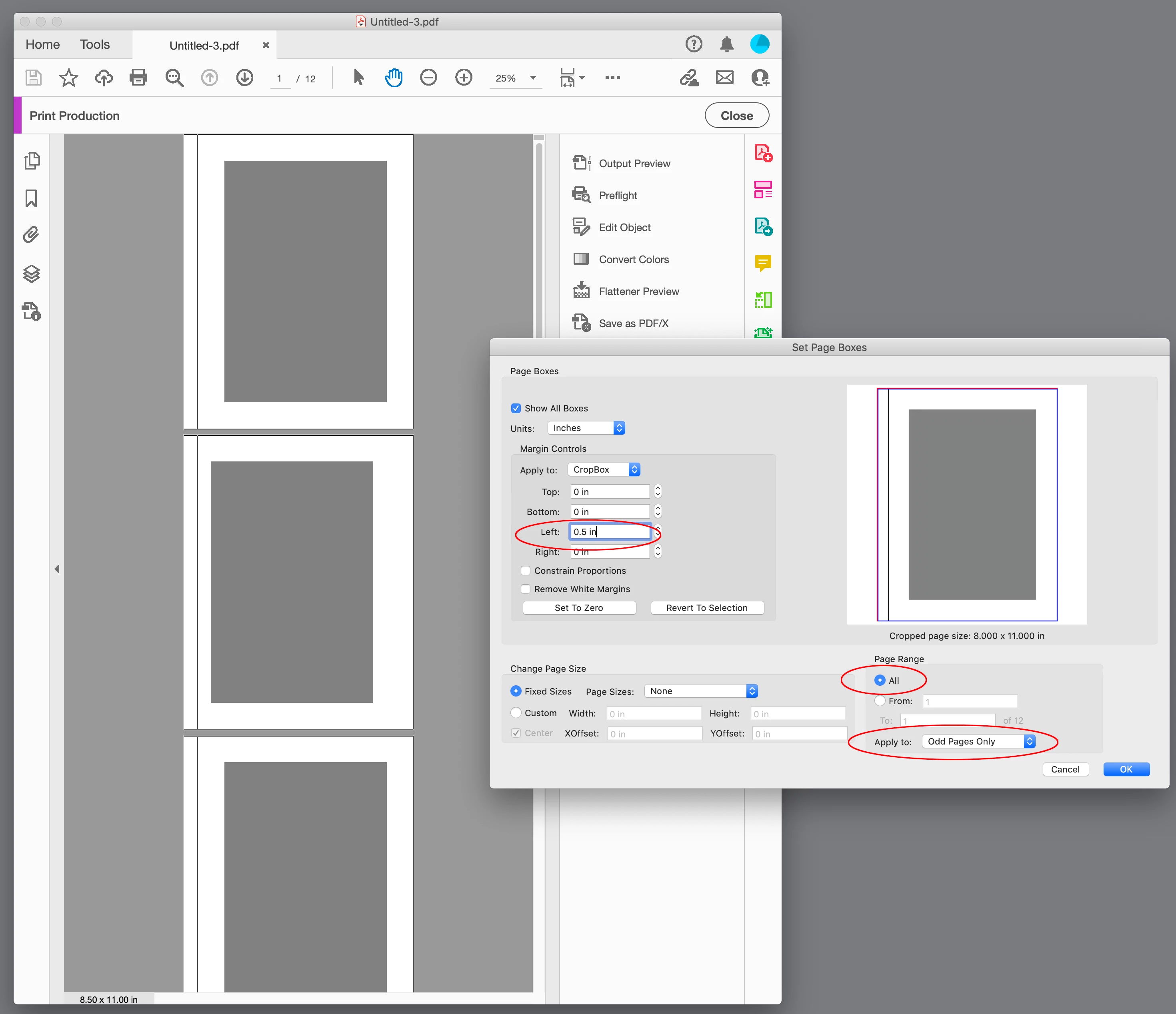

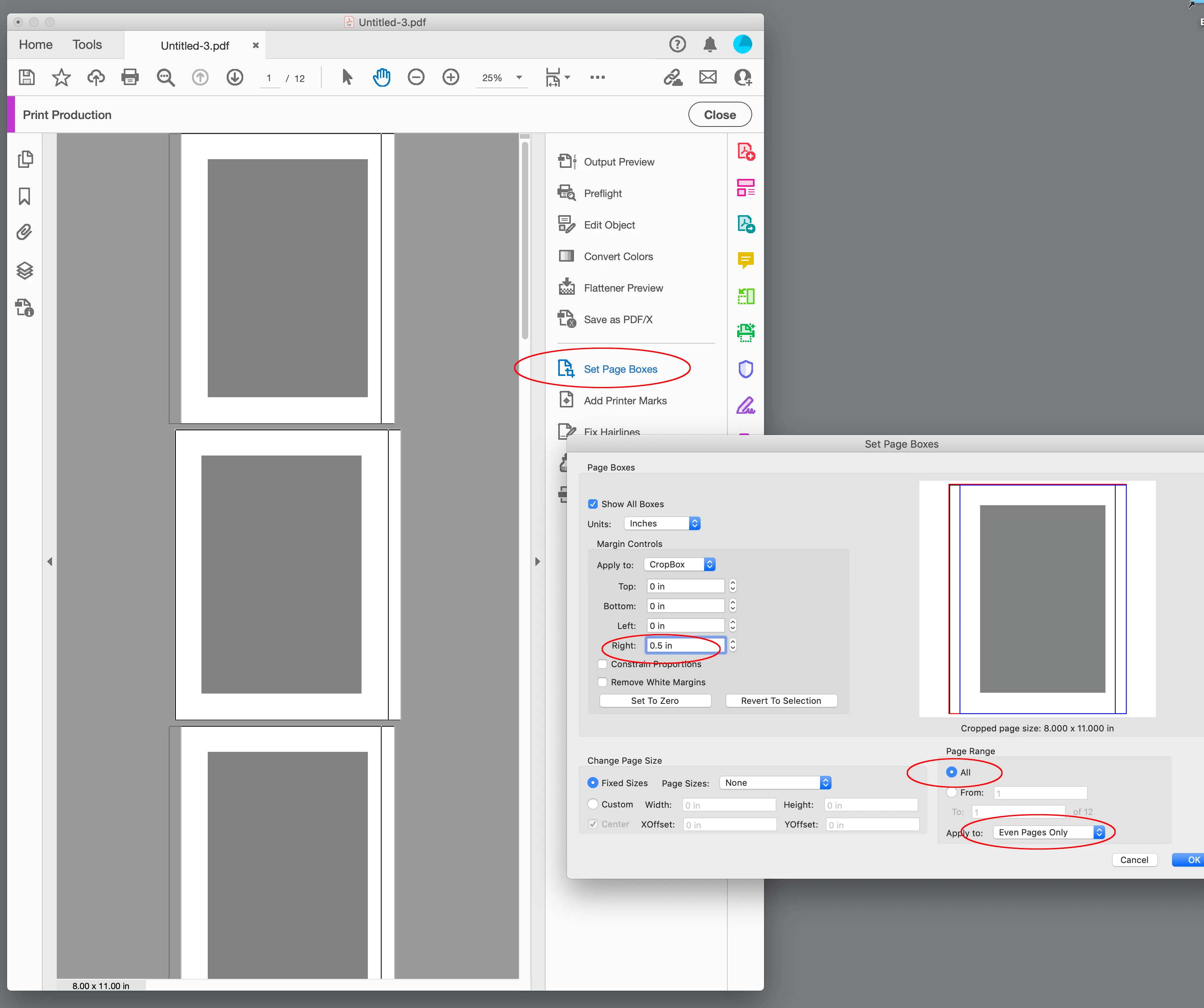

Hi @IcamI , you can also trim your PDF in AcrobatPro using Set Page Boxes in Print Production—trim the right side of the even pages, then the left side:
