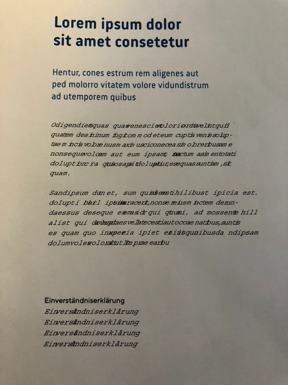

I have a variable font which don’t work as well in Adobe Indesign 16.0.1 on MacOS then printed on paper.

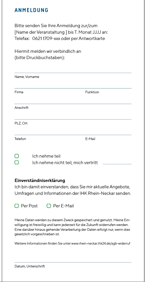

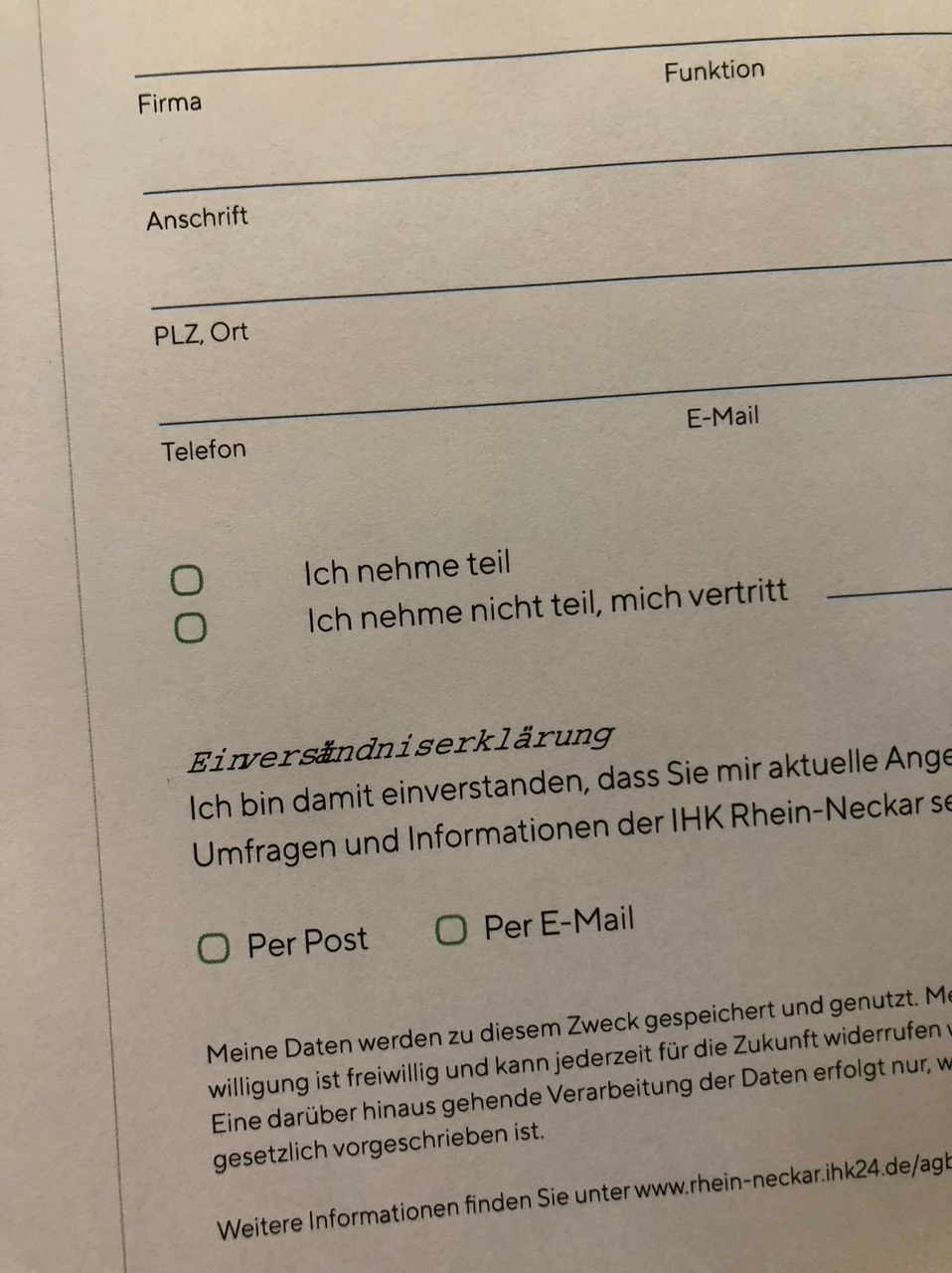

The main is first combination (1): the template designed in Adobe InDesign not print all font variations used there, as example weights 350 and 380 replaced to another font (it looks strange with broken side bearing in different places). Our variable font have weights from 100 to 950 defined as instances at 100, 200, 300, 400, 450, 500, 600, 700, 800, 900, 950).
If firstly save InDesign document to PDF and after print from PDF, then all fonts prints correctly.
As I think this situation happens only with old printers, because the second combination (2) of hardware and software prints correct directly from InDesign.
The (3) and (4) interesting, because printing on HP P2015dn from different operating systems produced different results. Windows10+HP print my template correctly from InDesign, but MacOS+HP broke all variable font variation exclude the first in the beginning of document.

I'm having the same issue with a Helvetica variable font (not concept font) that I purchased from Fonts.com and I too have a Xerox Phaser 7800 that prints like this. I'm currently on InDesign latest (v. 17.2) so I don't think this is the issue. It is fine in a pdf and can print from there but does not print out correctly on printer directly from InDesign.
Are there any other solutions available? I would rather print out from inDesign than have to make a pdf, print and adding that extra step in the middle.
