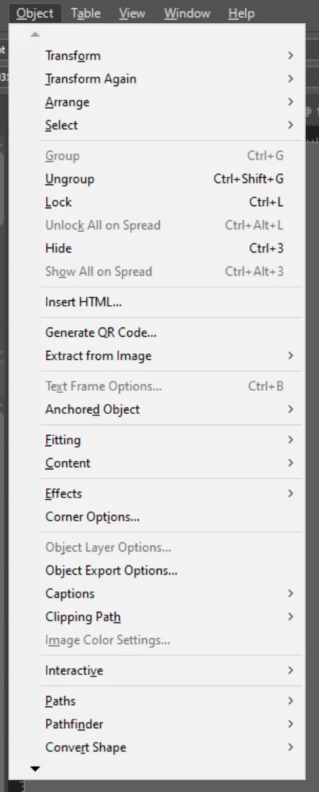

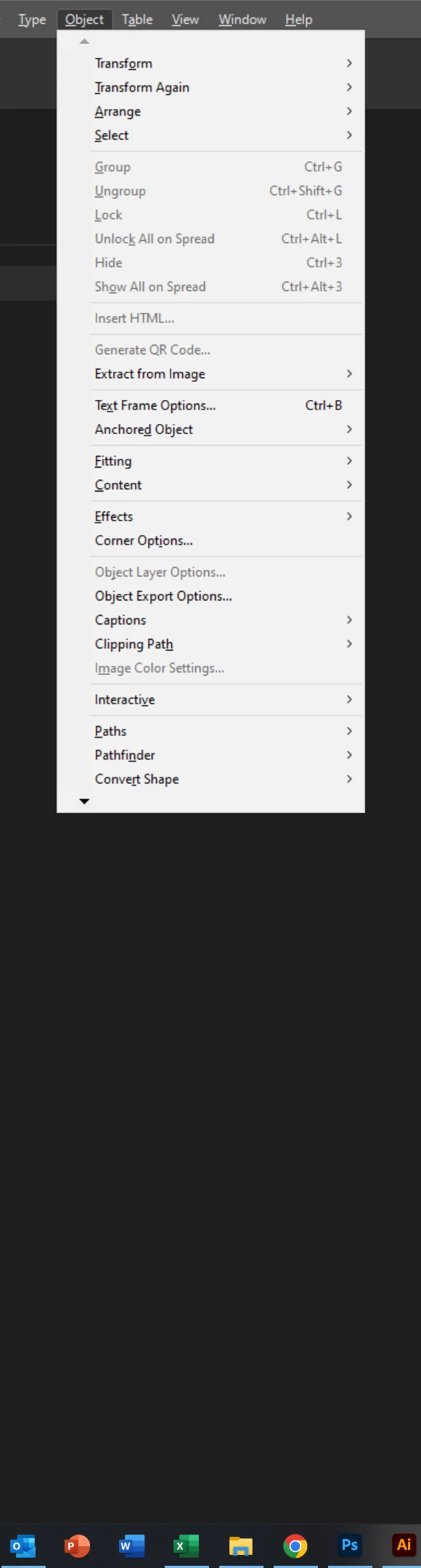

This issue seems to do with InDesign when its on a 4K monitor with Zoom setup. Im not sure if its a bug but essentially when I click dropdown menus such as the Object one it will not display all of the items in the list. Instead it adds an arrow to the top and bottom and a shortened list of items that i have to scroll through. The frustating part is that the menu has almost half a screen of room still to of been able to display the full menu so there is no reason for it to do this... And additional if i move InDesign to my other screen which isnt 4K all of the menus appear to be full length without shortening them and the up down arrows are not present. It also will do it on Right click contextual menus. It gets extreamly frustrating when you have to right click multiple things seperatly to do the same takes and the option is at the bottom of this list... you have to continually scroll back down bc the menu resets back at the top every time.

Very odd... I have those same settings in INDD but with windows at 150%. The Solution I found that isnt 100% ideal but does work is to go into Edit>Menu and hide some of the lesser used features in the few drop menus that were causing this issue and now at least the items i always use are there. Interestingly enough when i click show all it will actually show me the full list without drop arrows.

This only happens when i increase the Display scaling to 150%. At 125% it doesnt do it. But whats frustrating is the amount of space i still have below the menu so its just not realizing that at 150% my screen still has plenty of room to be able to fit the additional menu items. Yes i could keep it at 125... but that extra 25% help my bad eyes...

This method could be helpful except for right clicking an option where the context menu will still come up as compressed.

In case of the main menu - as per your screenshot - you should be able to separate document's window from the application - I think? (replying from my phone so can't check but 100% you can do it in Photoshop)
