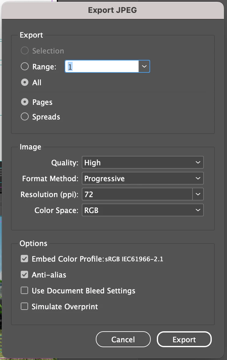

Hei.
I had same problem. But my bleed settings were 0px.
I solved it by exporting it in .JPG set lower resulution.
Addes a screenshot with export settings.
