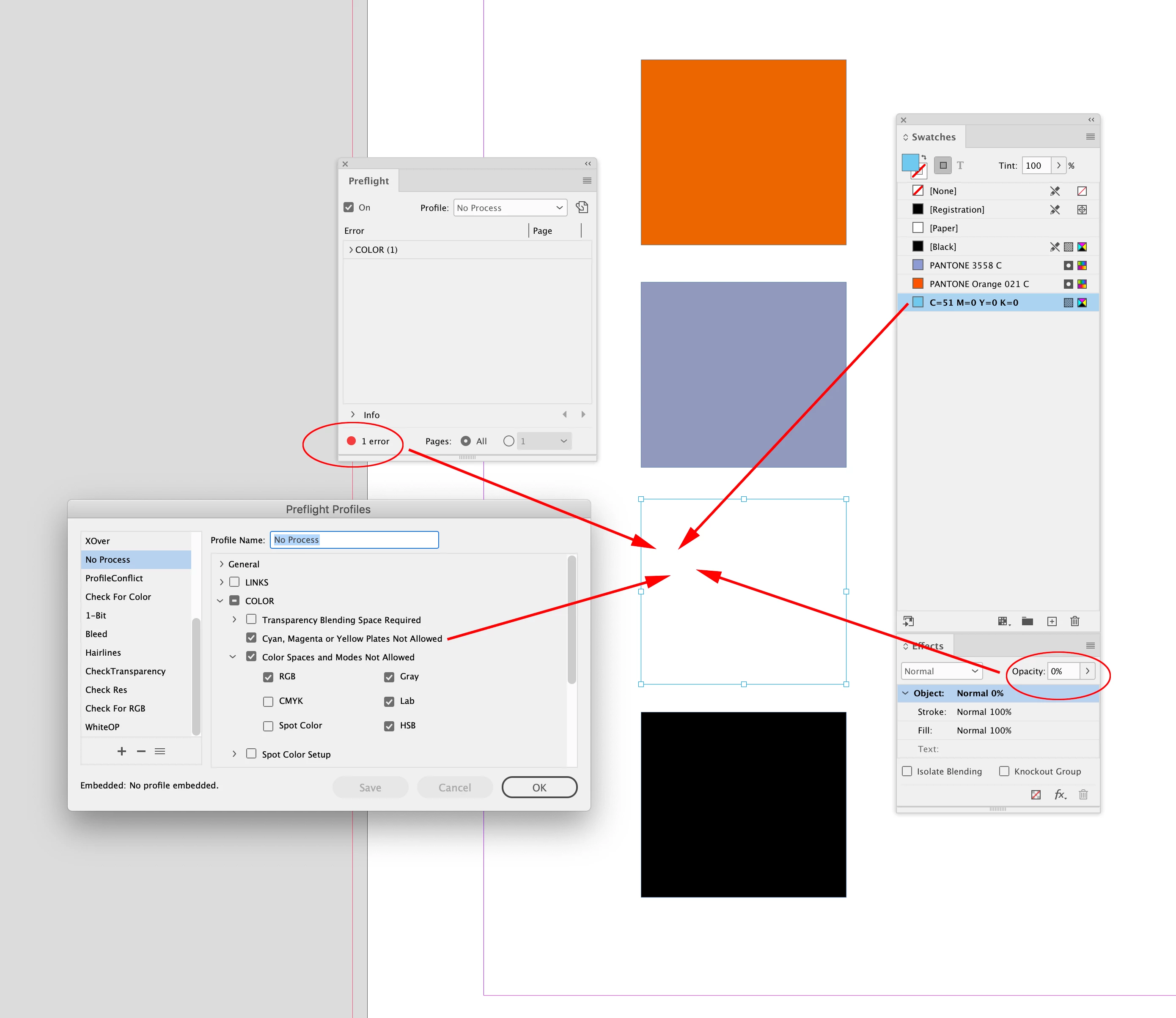

Hi @matejsussi , All PDFs have at a minimum the 4 process color plates, or if the export is to a Gray profile a single Black plate. You can setup an InDesign Preflight rule that would flag any CMY usage, but allow Black and Spot colors. Something like this gets the white rectangle because its fill is Cyan set to a 0% Opacity:

Don't worry, if you have in your exported PDF, CMYK + those two PANTONE colors - it's not a big deal as the place you want to print them can generate printing plates for only those two PANTONEs and ignore CMYK.
