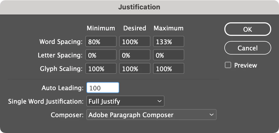

Correct answer Eugene Tyson
With no documents open you can set the auto justification to 100%.
That will be default for all new documents.
It wouldn't affect previously created documents.
It's also something that is part of the Paragraph Style.
And you should be using Paragraph Styles.
Typically, I create the Body Text style first, then when creating other Paragraph Styles I will use the Based On style.
Then you only have to adjust the Body Text style to change the auto leading.
I use  Auto Leading all the time for complex leaflets, and it's great for reducing space everywhere to fit text in tight spaces.

All professional typographers would define leading via Paragraph Styles.
Scott Falkner
August 16, 2022
You can achieve solid leading by changing the Justification options for your style to 100% for Auto Leading. This only affects the selected paragraphs or style.
Eugene TysonCommunity ExpertCorrect answer
August 16, 2022
August 17, 2022
quote
By @Eugene Tyson
MIND = BLOWN
I had NO idea. Problem solved. Done. THANK YOU!
(...who put that under “JUSTIFICATION”?!?!?)
