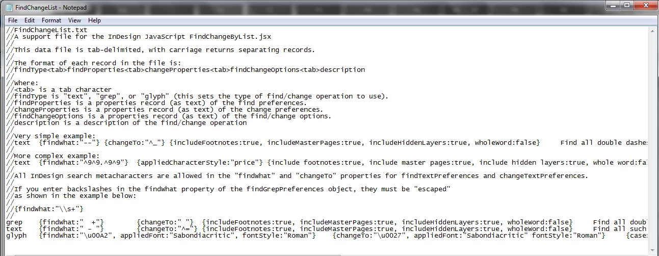

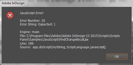

I want to use a glyph-code, but when I run the script — it gives me the following error-message:
Are the glyph code correct? If no; how would it look like?
I would appreciate your help.
Regards Modassir

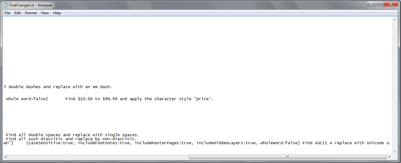

Correct answer Mohammad Modassir
I had to change from Unicode to GID/CID to get the correct ID, moreover I used wrong glyph-code as a whole, the correct is this one:
glyph{glyphID:132, appliedFont:"Sabondiacritic", fontStyle:"Roman"}{glyphID:10, appliedFont:"Sabondiacritic", fontStyle:"Roman"}{caseSensitive:true, includeFootnotes:true, includeMasterPages:true, includeHiddenLayers:true, wholeWord:false}Find ASCII A replace with Unicode x.
..so it works now.
Thanks for you concern. And thank you so much for helping me out with codings in my previous posts. Thanks a lot!
Have a fantastic day!
tpk1982
May 12, 2016
Hi..
I hope, the error is shown for your script file FindChangeByList.jsx and not in the FindChangeList.txt
Mohammad Modassir
Mohammad ModassirAuthorCorrect answer
May 12, 2016
..so it works now.
tpk1982
May 12, 2016
Ahhh.. i too missed..
