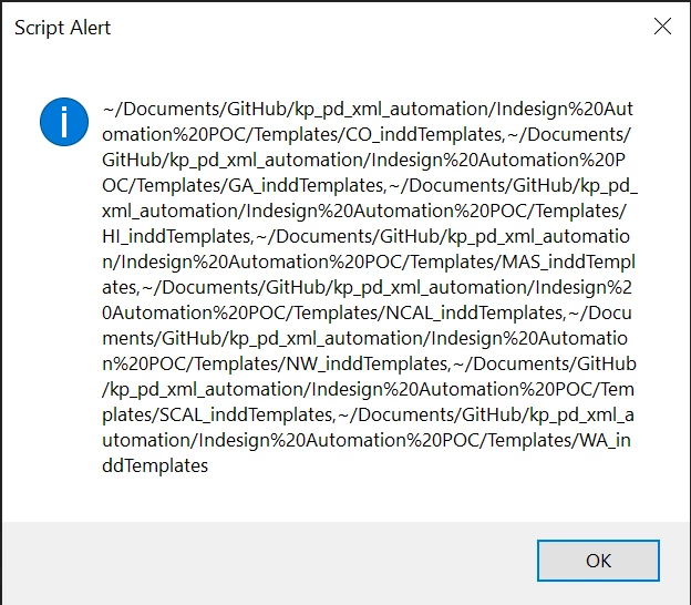

If I set the alert to
alert(rgnTemplateFolders);
 The script produces the following:

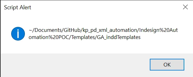

If I set the alert to:
alert(rgnTemplateFolders[1]);
I get:

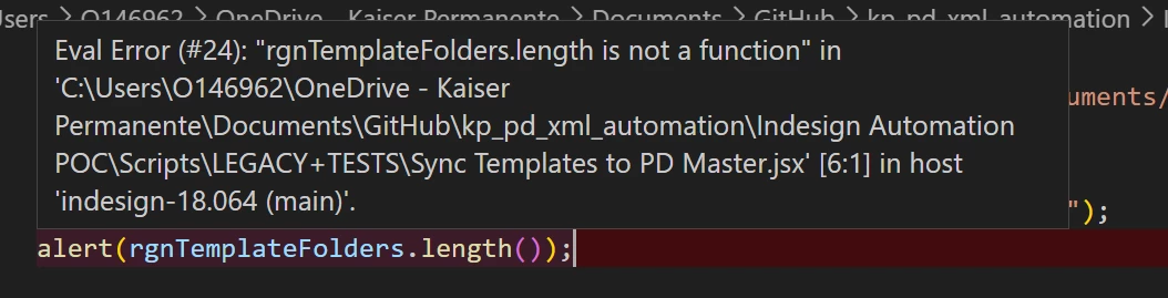

BUT, if I set the alert to:
alert(rgnTemplateFolders.length());
I get:

Seems to me that all's well, you get what you asked for. The list of folders shown by
is an array. And
shows the first element in the array.
returns an error because .length is a property, not a function, as your error message tells you.

Well now I feel a bit stupid. A colleague pointed out that I needed to use
alert(rgnTemplateFolders.length);
since length is a property and not a method. 🤦‍
