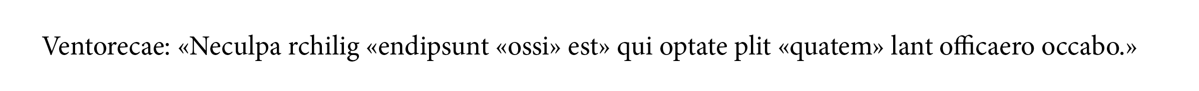

Hi, I am looking to find and replace quotation marks within quotation marks, as example:
He cited: «As someone said «I need to better understand grep» and he was right».
Sorry for the silly example, but I want to find and select the second « (in order to replace with "), so i guess the line should said something like: '«', after another '«' followed by whatever except '»'. But i really cannot do it.
After that, I should select the first » for same reason.
Thank you

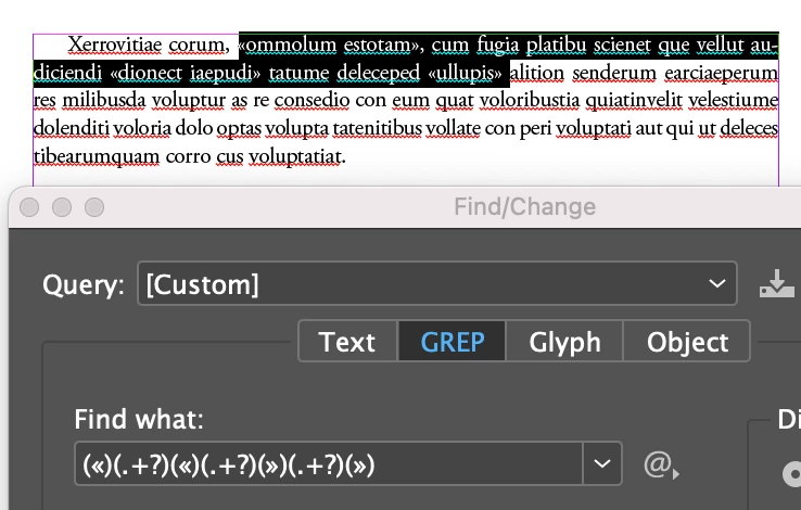

It would be absolutely possible to do this one with a lookbehind, but that's not how I started figuring this one out. Can you go into more detail on what you're trying to do? It sounds like you simply want to replace all double chevron quotes with double quote marks. I'm not sure why you'd want to do it in multiple passes; it looks to me like it's best done in one pass.
The "followed by whatever except" bit is easy enough to do in GREP. If there are multiple nested quotes in a single paragraph, we'd need to have an expression that wasn't greedy; we want it to stop at the first double chevron close quote, right? The expression for that is
So my "Find" expression would be
 and my "Change to" expression would be
"$2"$4"$6"
because enclosing an expression in parentheses allows you to handle each parenthetical expression separately in the "Change to" field by addressing each group with a dollar sign. So this one replaces all the double chevron quotes with typographer's quotes. I would assume that you'd want the nested quotes to be single quotes, not double quotes, so I'd suggest this "Change to" expression instead:
"$2'$4'$6"
which leads to this behavior:
If that's not what you're looking for, please do post again and fill us in.  If you absolutely had to do one pass to replace the inner quotes, followed by another pass to replace the outer quotes, the first "Change to" expression would be more like
$1$2"$4"$6$7
(Also I'm sure that my method is a bit of a brute force method, and there are far more elegant ways to pull it off.)
"$2"$4"$6"
"$2'$4'$6"
$1$2"$4"$6$7
November 9, 2023
I'm sorry but this solution leads to a problem, that it finds and selects also three subsequent quotations
