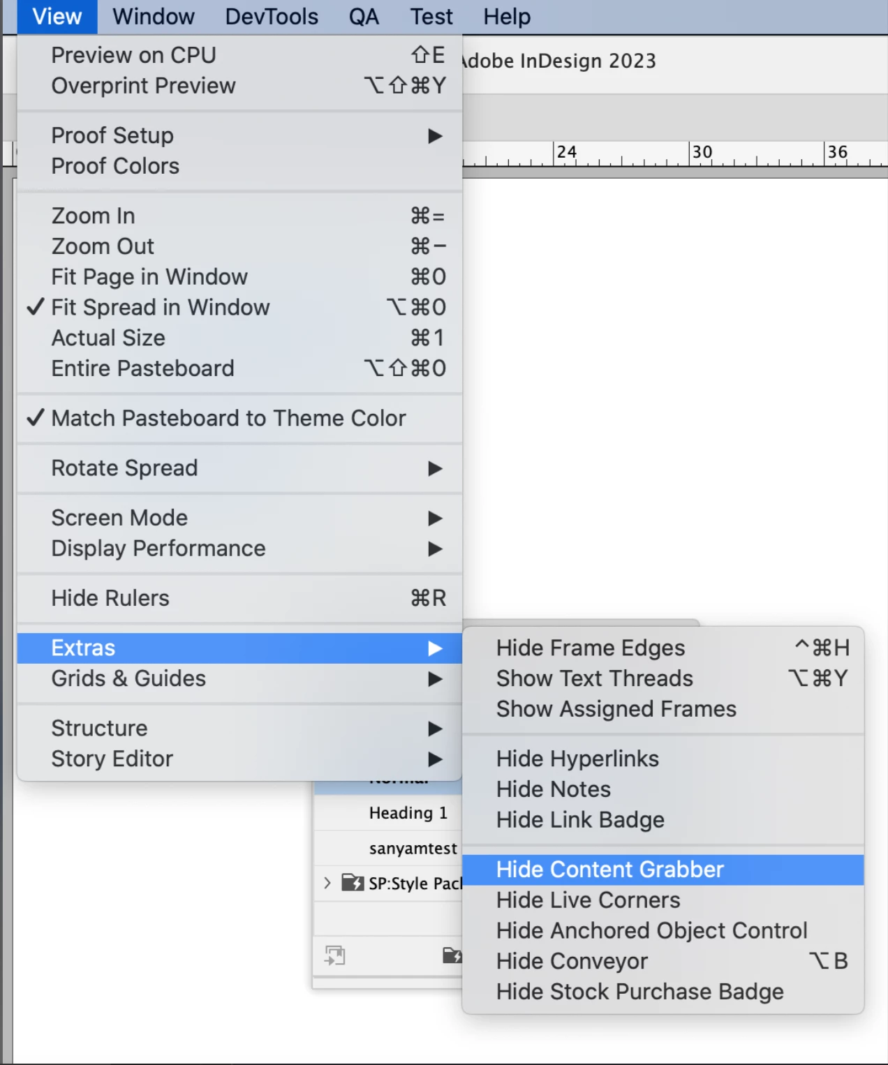

I have unchecked the 'Highlight objects under selection tool' option in preferences. but boxes containing graphics continue to highlight uner the selection tool. It's really itirating, I thought adobe had stopped this. Does any one else have this issue and is there a fix for it?
Correct answer Rishabh_Tiwari
Sorry for the delay in response. Along with the settings in the preference, you can  switch off the option of Content Grabber, please refer to snapshot:
Let us know if this helps or if you need any further assistance.

Hi @lawrencem85542639,
Thanks for reaching out. I tested this on my end on the InDesign 17.3 & macOS and it seems to be happening only with boxes containing images. I'll check this behavior with the team and will update you shortly.
@aniri5j9ox8tw2ln Did you test this with an image in the box? If not, could you please test and let us know if you're able to reproduce the issue?

Wenn ich diese Funktion abschalte, dann wird in der Tat nur bei Bildern in der Box den Rahmen rundum angezeigt. Sonst ist es korrekt deaktiviert! Seltsam... ein bug?

Hier unter Monterey 12.5 und ID 17.3 klappt es ohne Probleme, wenn ich die Option ausschalte wird kein Objekt mehr hervorgehoben...
Hast du das übliche probiert? Neustart? Cache löschen? Unter einem neuen Benutzer getestet? Eventuell ID neu installieren?
