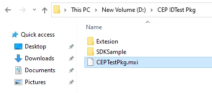

Pkg Folder Structure -

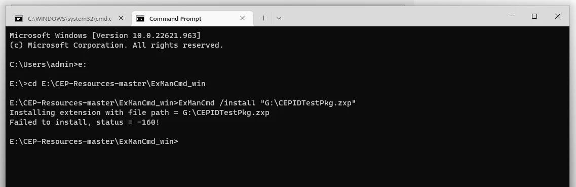

Thank you for immediate reply and sorry for late reply, I was busy in other work. I have did the changes in the mxi file as suggested but still getting same error. Please check below mxi file data and attached error screenshot.
